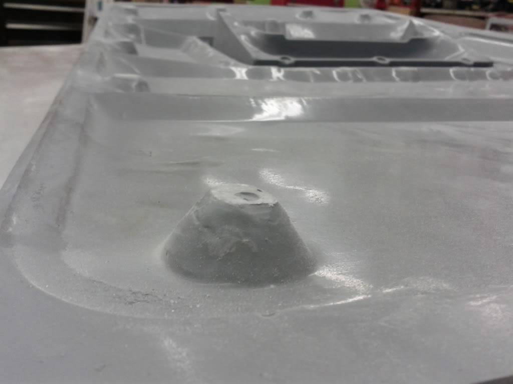

ya don't buy this one i did, its a non functional setup, only made for looks, its taken me so much work to make it useable..
They sell a functional setup, you just have to buy all the stuff to make it function.
I had the parts as well you can see the door in this pic was not cutout or molded for the swinging arms to open/close the door, this was one of many problems i had...
