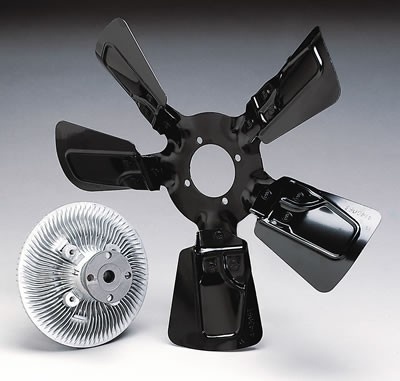

The fan I'm using on my 440 came off of a 383 with no clutch.
The fan you need will look like the one in this picture:
The direct drive fans do not have that big hole in the center.
