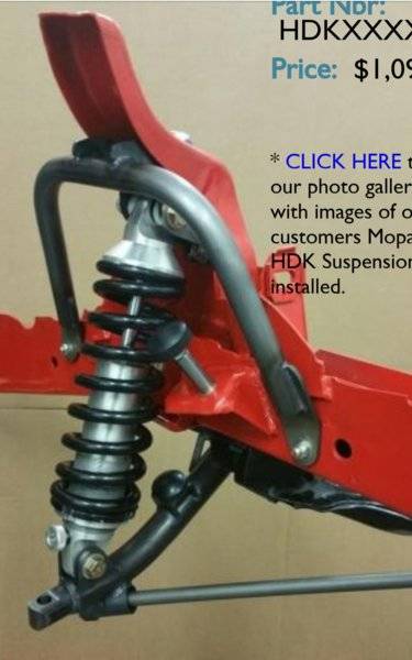

Has anybody used this Torsion bar eliminating kit from HDK. I have a 69 roadrunner that I did a Gen III Hemi swap and really dont want to swap out K frame since the motor and transmission are all done. I just want to do a little front suspension mods to improve ride and came across this kit.

Great stuff, if you're looking to lose the torsion bars. I believe it's the cleanest and most thought-out after-market design. I'm personally good with torsion-bar front-ends, anything shy of a chassis-car.

My gen III conversion went great. Like you said it was pretty much plug and play. I did have to do alot of tunnel mods and cross member modifications cause I used the RFE transmission right at the torque boxes where the torsion bars go. I figured doing a coil over front end would take some stress off the torque boxes and also improve my ride. I'm just looking at my options and see what I come up with. And the tti headders i need for my motor are the D shaped port )2016 motor) require that I hit them with a hammer to make them fit. I can't see myself buying $1000 headders and hitting them with a hammer. tti knows you need to do it they tell you you need to do it, they should already be bent before the powder coating.

I had hdk on on two cars.. without a doubt they rode great and denny is a first class guy.. he has done many an A body check that forum for reviews as well. Had them on a 68 barracuda and 63 plymouth
I spoke with Denny a few days ago. He discontinued this setup due to it wasn't in demand for the b body.
