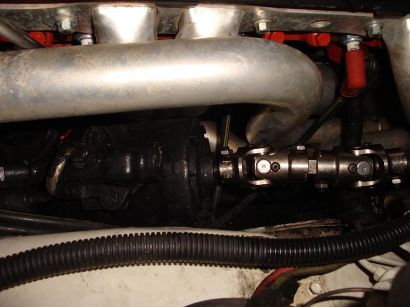

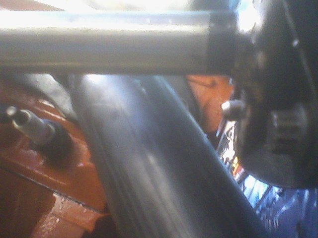

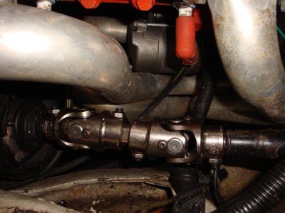

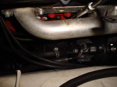

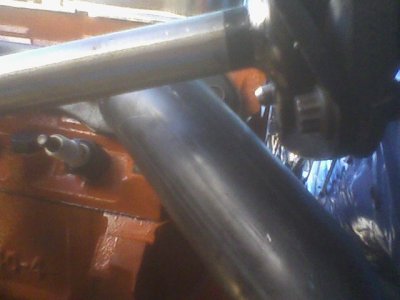

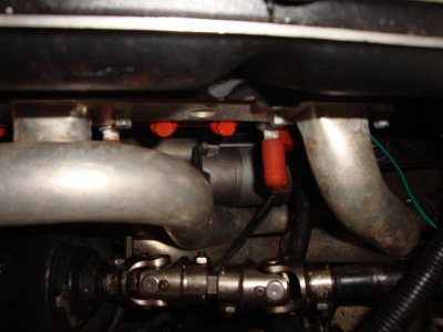

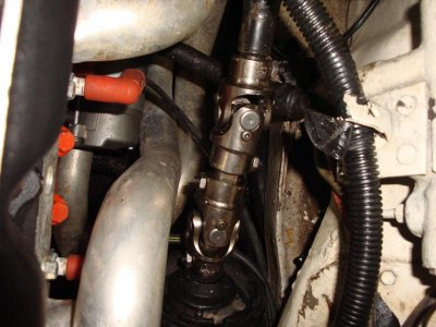

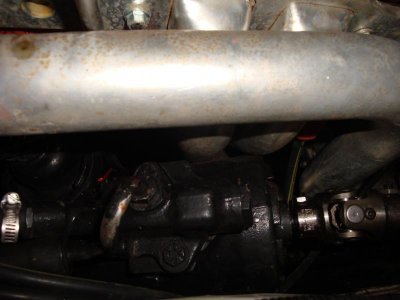

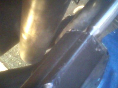

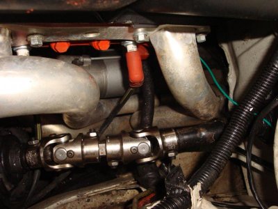

DSC03092.jpgDSC03091.jpghere are the pics of the headers everyone wanted to see.DSC03097.jpgDSC03096.jpgDSC03095.jpgDSC03094.jpgDSC03093.jpg
What kinda cobbledness is that you have for a steering shaft and u joints?
its made by flamming river the only way i could get it to work with the rubber isolator. they use on the 73s rr its what every one on here told me to do it works great its alot nicer that the big pice of rubber. why u so critical rebel? if u have a better way to work around the headers let me know? i couldnt even get the sterring close to the steering box was hitting the rubber isolator.
It just looked strange and outta place is all. I knew it wasn't the factory stuff. I would think two u joints in a row would try to wad up and not rotate freely........but if it works do it.

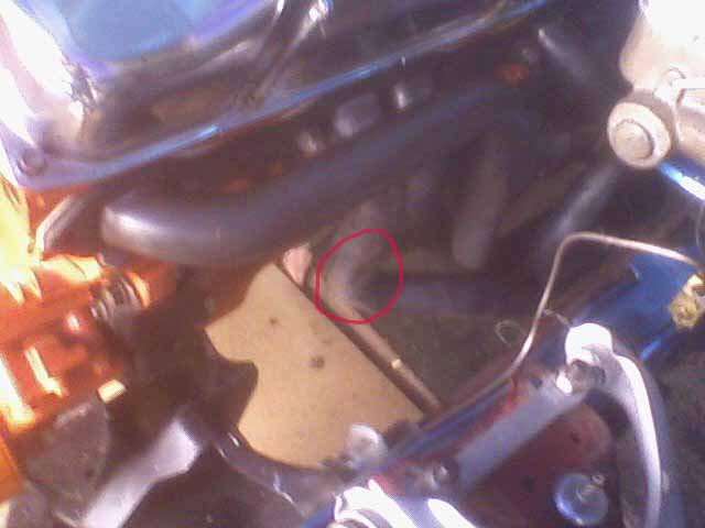

mine has the same rubber isolator. the headers work fine with the factory steering coupler and the steering shaft. you must have something funky going on with the way the engine is mounted in there. plenty of clearance on mine. I have a full size starter as well. I put one little dent in mine (circled in red) to get a little more clearance for the steering box, although it did clear, I just didn't like how close it was. that was the only dent I had to put in them. they fit like a glove. my dipstick tube fit perfect under the header tube and above the steering box. it was so much easier to just take the steering box out, the 3 bolts for it are easy to get to from the bottom of the car. this way I could out the starter on, drop the header in from the top , and then slip the box in there.

the 73 rr use a thick isolator n it was hitting the pipe so i didnt know what to so so one of the guys on here told me this is what he had to do he had the same problem with the inch thick isolator so close to the stearing box u have to rember im working on a 73 rr originaly a 318 car thanks again patrick the steering now works great
my 74 had no isues n my isolator is over a inch thick from the factory i had no choice and now no hitting on the steering but got a email from hedman today there going to send out the new revised header today for the starter and gear box issues
