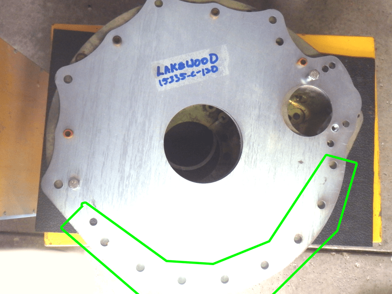

Lakewood Scattershield ID
There’s a cup bolted to the BH for the starter nose. The other position is for the 130 T FW.
I had to have a sleeve to take up the slop in one of my starter mounting holes. Using a Dakota style starter.
I posted about shield to block alignment in post #9. On the chance it wasn't done and possibly the mesh is to deep on the starter. Don't think it's possible but never know. Mine was off .014.
