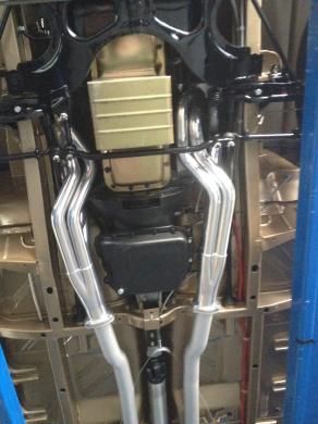

I put the TTIs on my 70 Superbee with the Hemi
Easy!
Beautiful!
I did have to take my time on the passenger side....tight fit!
I did what Dennis H suggested: Ceramic, Polished
Got them for the 63 Polara also.
Easy!
Beautiful!
