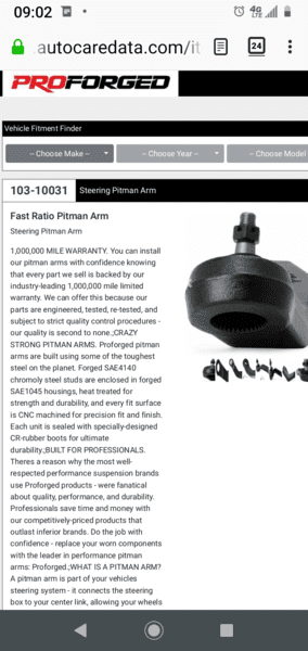

I don't know what the difference is from 67 to 68 but you can check these out. Listed for 68 to 72 for the Coronet for the fast ratio but the stock replacement are listed for 65 to 72?
The same applies to the fast ratio idler arm
