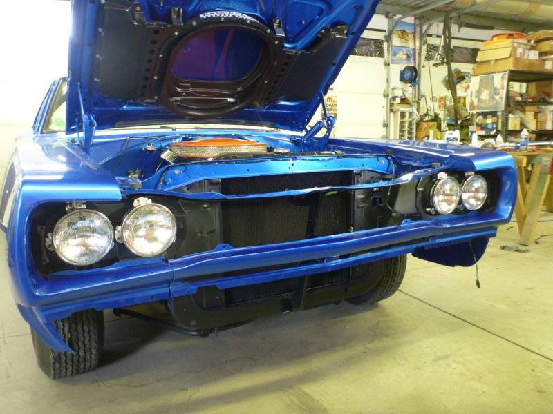

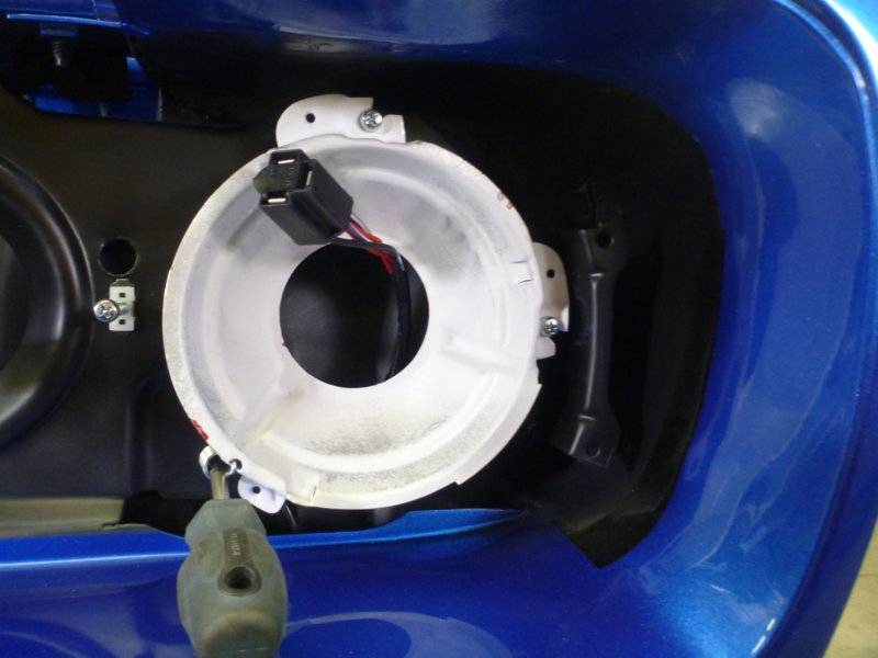

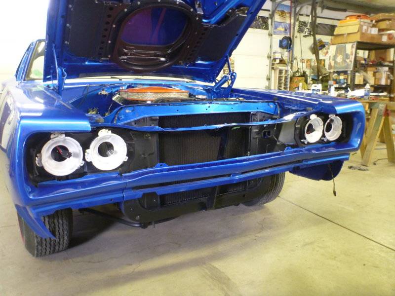

Well my car is not close, but I think they’re all the same; bezel screws all same length too.
Is '68 different than '69? '69 just uses a clip nut on the metal stand off.

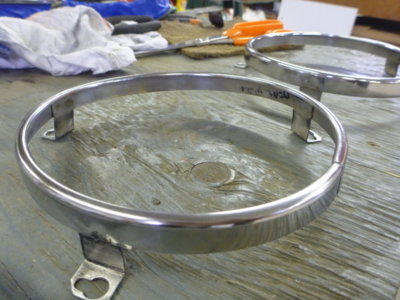

Does anyone reproduce the stainless trim rings ?
I do know that the '69 setup differs from the '68 setup. In the case of the '69, both headlamp buckets sit at the same depth.

No picture.. '69 grill is the same, center + outboards, but the outboards screw into clip nuts that go on the metal stand off shown above. Didn't figure '68 would differ, but apparently it does so I can't help.
Should be lots of "as removed" rings out there. Mine looked like crap so i bought someone's take offs.. and then ended up polishing my old ones to better than new condition anyhow.

And no repo's. If you screw up removing the anodisation like I did, you have many hours of sanding ahead of you to smooth it back out!
