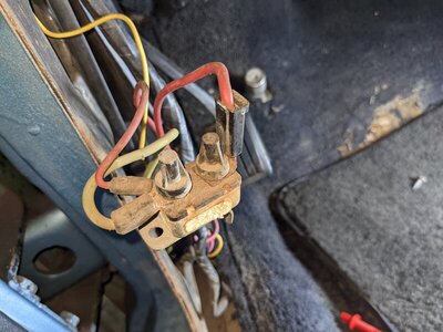

I've been scouting around for a replacement circuit breaker for my headlight motors (67 Charger). Can someone share a part number or let me know if there's a modern replacement part?
Thanks!

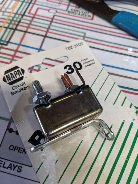

Sometimes I make things harder than they need to be.
For anyone else that may be on the search, the Napa breaker came with a bracket (just had to bend it )

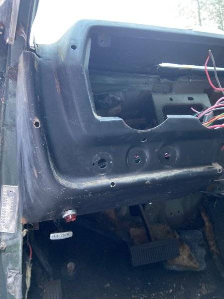

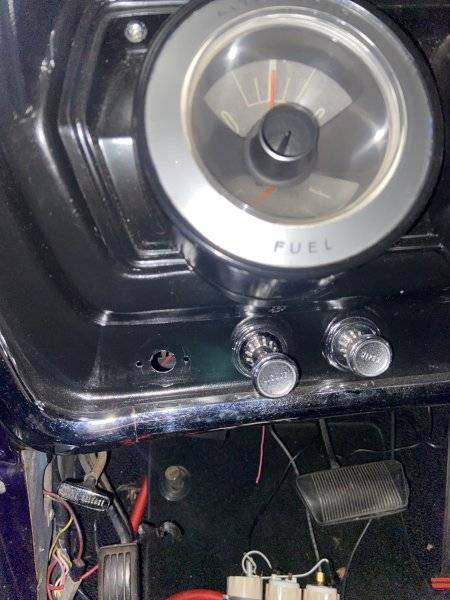

There stuck open, they have been that way since I bought the car. I have not done anything to them. I’m not sure of how to close them they do come on when I pull the knob and the brights work when I press the floor button. This is my first encounter with this style. My dad restored one when I was 5 and fell in love with it and wanted one my whole life. My wife found this one and now I’m restoring it.
Yes they are trying to close.
You should have a "hold headlights open switch".
This disables the close relay.
I knew something was missing
Now I have to find one
And my parts car don’t have it figures.
