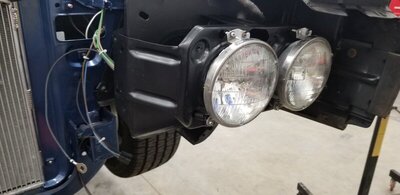

I'm just finishing up the wiring on my 71. Does anyone know where's the factory gound location for the headlights? I could just ground them anywhere but it would be nice to put them in the right spot.
Thanks

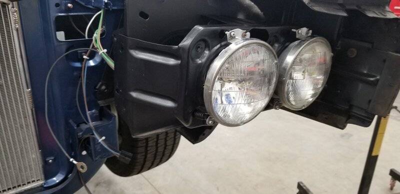

yes, but the bulbs don't ground to the housing as they are glass. They have a wired ground ( as seen in the pic). Just wondering the correct location for the wired ground.
Right in front of the battery on the core support just on the rear of the square hole the harness is coming through.
The single wire on the radiator core support ground provision is the small one from the negative batt harness
