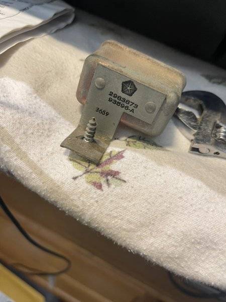

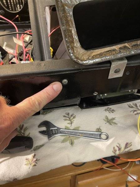

Trying to figure out how mother Mopar mounted the headlight l/key warning buzzer. There is like very little slack in the harness so it can’t be very far.
Thanks
I figured it out. For those that ask the same question here is my answer. Its the only one possible and it fits like a glove with the original hardware.
