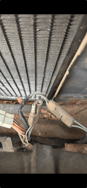

I was checking out the headlights today. As I was checking, with the headlights on, I was getting some slight clicking from the relays. Also I found this on the driver side, which is stuck half way. I couldn’t find the connecting lead for it.
open.

Should the driver side have a limit switch on the top? The reason I ask is that the passenger side has a limit switch connected, but the driver's side does not. I cannot find a connector to hook up to the wiring harness. You can see what I mean in an earlier post.

I just tested my motors, and they do work. but one side may be missing the limit switch. I have a disconnected lead from the harness, but nowhere to hook it up to.
