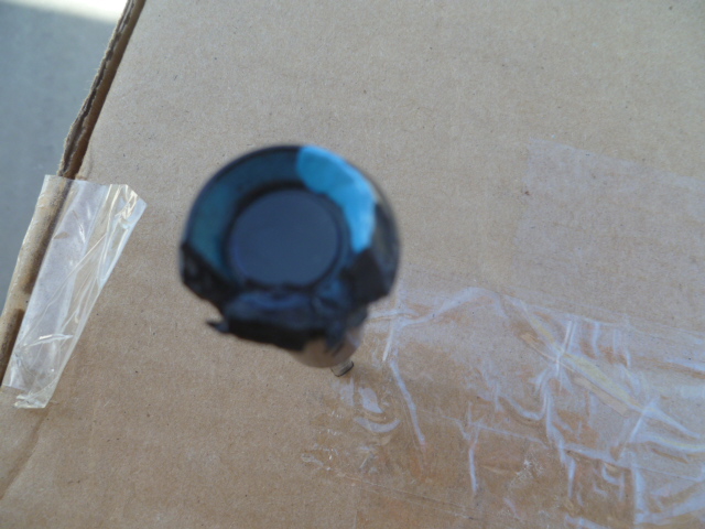

I've been working on my rallye cluster and found this blue paint at a hobby store. I thought I'd try it on an old broken headlight knob. The knob is pretty faded, so not sure how it looked originally.
Does anyone know if this color looks close ?

I always thought of it as Petty blue, so yeah looks good. What is the name, mine are all worn off as well, wiper and headlamp knobs.
The color does mimic petty blue. I bought a 2oz bottle at Michael's (art supply store) for less than $2
It's called Americana Gloss Enamel and the color is Calypso Blue. The paint is made for glass and ceramics so it should wear pretty good.
Now I need to figure out how to paint the knobs and maintain the sharp lines. Maybe some painters tape or ?
Thanks for the help!
The blue engine paint is a good idea too. I think I'll try what I have here first. If it turns out crappy, I'll try your paint idea.
Masking those little knobs for paint is gonna be difficult I think?
Mask around the outside with tape and for the center that supposed to stay black, get a cue tip or small paint brush and some petroleum jelly, cover the center black part with it. Paint, once done, wipe off the petroleum jelly, and wah-lah its done!
