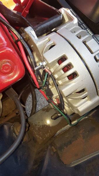

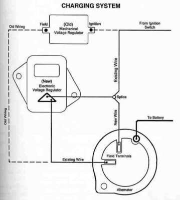

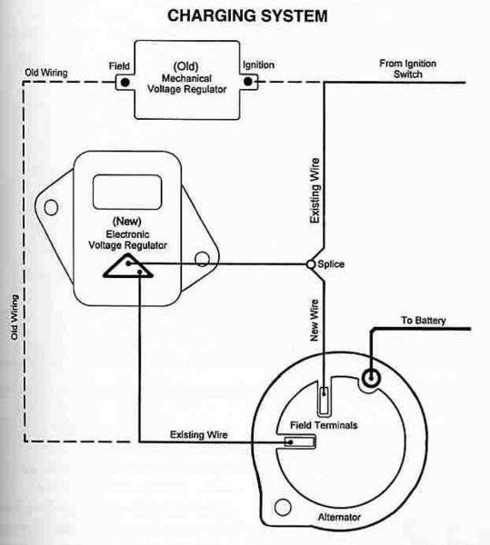

https://www.forbbodiesonly.com/moparforum/threads/two-field-alternator-connections.113992/
So the options are:
lf using the mechanical voltage regulator, ground one field terminal.
If using a electronic voltage regulator, run original power from ignition to both the regulator and one field terminal. The other field terminal can use the same wire that went from the regulator to the field on the alternator.

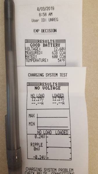

I charged battery last night, went to advance auto first thing, guy actually called me earlier, they tested the:
Battery, fully charged.
Alternator, no voltage.
I asked if it could be the voltage regulator, the older guy said if it was the charging would spike and fall.

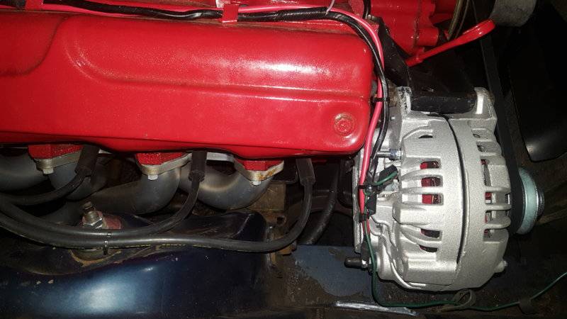

Below is how I grounded the second field on the alternator.
If I'm not missing anything here, I'm just going to return it.
It's 60 amp, the other one available is a 35 amp and it has 1 pulley, I'm thinking it also has 1 field.
Btw, for those who deal with advance auto, apparently you cannot return an item to a different AA. I guess it makes sense, but then again not because they can get me an alternator from another store by 5pm, but not return one to it.

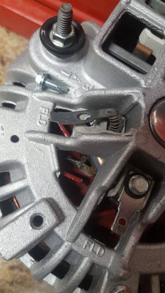

Help me out here, if both the old new alternator, and the new new one I just picked up, have no rubber insulator and the tab cut off on 1 of the field connections, it is already grounded, yes?
Also, if changing to a electronic voltage regulator in the future, does this field connector need to be, say, un-grounded?
I was unable to find this scenario searching but I did find how to test for a draw and I do not have one.
It looks like it should be ready to go on the engine and work-
just screw in that second field terminal, including a metal washer(grounded), and plug the field wire into the field terminal with the rubber insulator.
If changing to an electronic VR, I think both terminals need to be insulated(un-grounded).
