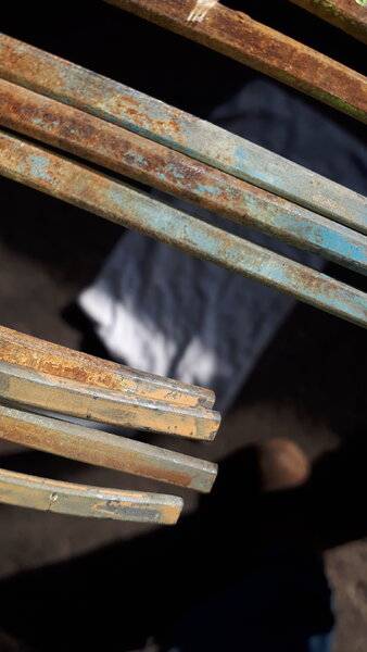

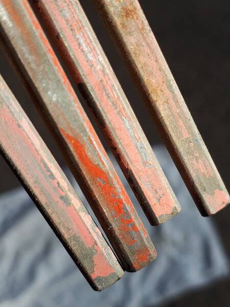

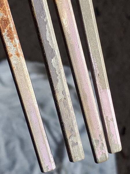

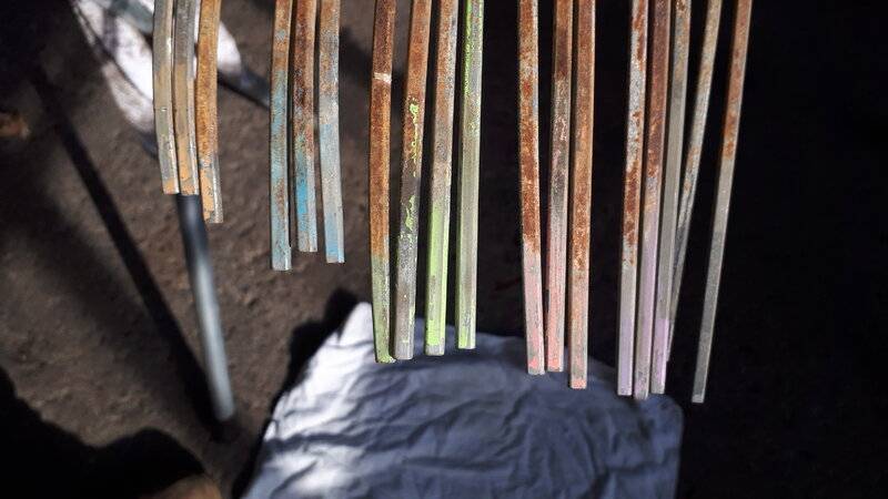

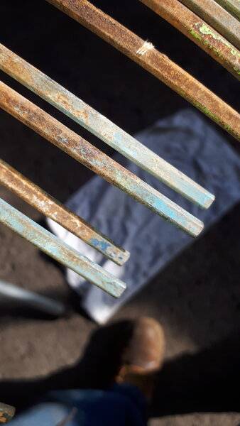

There is a difference, 68/70 Charger & all other 68/70 B body , Charger starting at the back, 1st Black, 2nd Light Purple, 3rd Pink, 4th Lime Green, 5th Light Blue & 6th or front Orange.
All other 68/70 B body, 1st Black, 2nd Dark Purple, 3rd Red, 4th Dark blue, 5th Lime Green & 6th or front Brown.
1st Black (rear ) are slightly longer & 4th Lime Green are virtually the same.

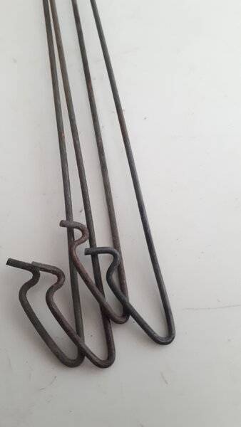

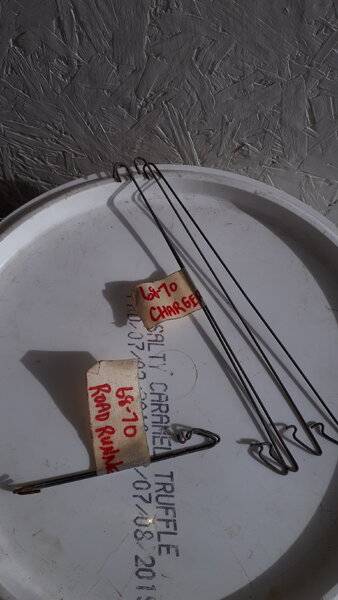

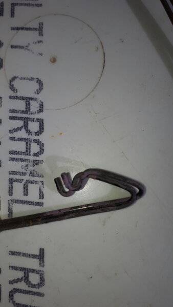

Also the rear bow retainer springs are color coded, & different lengths. Charger springs are longer & Dark Purple & all other 68/70 B bodies ,shorter & pink.
