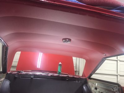

Need good positive input on installing replacement headliner in 67 Gtx hardtop
Well me and the wife did our 67 together and were still married. :rofl:
Seats out front and rear.
Start at the back and work to the front. then do the sides , just going a little on each side stepping back and forth.
sail panels last.
put all your coat hanger, dome light , sun visor screws in the holes before starting so you can locate the holes and just make a tiny slit to get the head through. do not cut anything until you are sure its done and your happy.
use the 3M adhesive but we had better luck spraying it into a paint cup then apply with a foam brush. stick and separate a time or two before the final stick down.
I did my first one last summer (it took ALL day) and it came out great. That being said you have to go slow and be patient, I first tried the brush on glue and it just would not hold so I used the 3M spray adhesive and lots of small
spring clamps to hold it in position.
