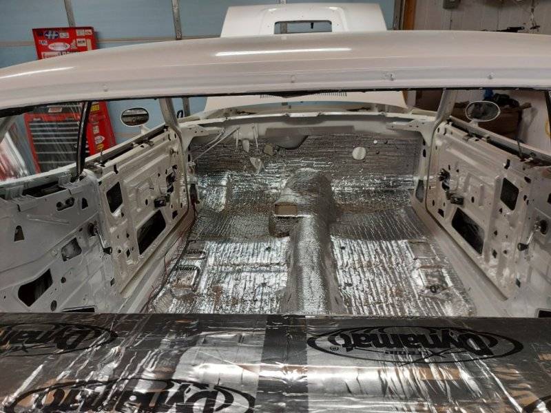

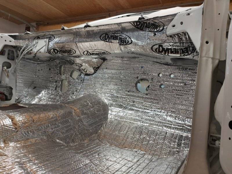

I just ordered some of the el cheapo stuff for around $1.50 a sq. ft. should be here in a few days will get back if its any good for install, adhesion, etc. Bought the Dynamat before, was nice stuff, but around $7 a foot. that's a hell of a price difference. I could double it up and still cost less than half.

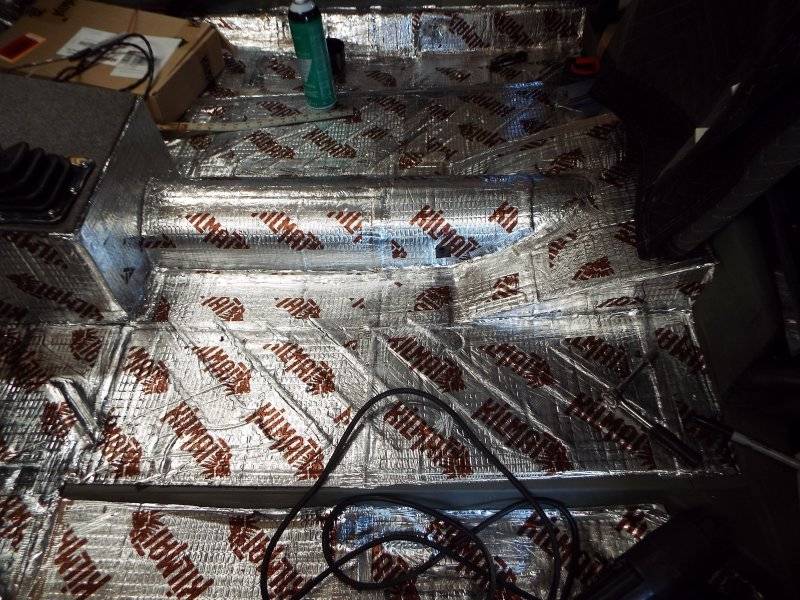

I used Kilmat on the floors and in the doors of my 69 GtX. Behind the rear seat I used a repro cardboard barrier that I covered with self adhesive duct insulation from Lowe’s. Made a huge difference in sound reduction. I’m very happy with the results.

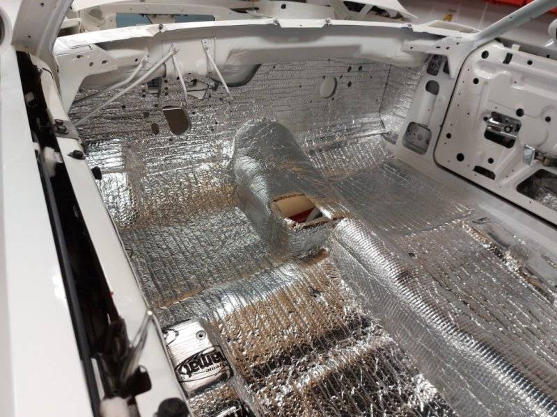

I first installed a layer of Nudura self stick butyl waterproofing membrane, and then added the Siless 157 mil reflective membrane from Amazon over that. This made a noticeable difference in both sound and heat transfer through the floor.
I used Kilmat on my 65 AFX Coronet, got it from Amazon along with a set of 3 rollers to form it to the floor, cut with a pair of scissors want down easy using the rollers also from Amazon. I covered all the tubs and back package tray, would have had more pics but camera took a dump.
