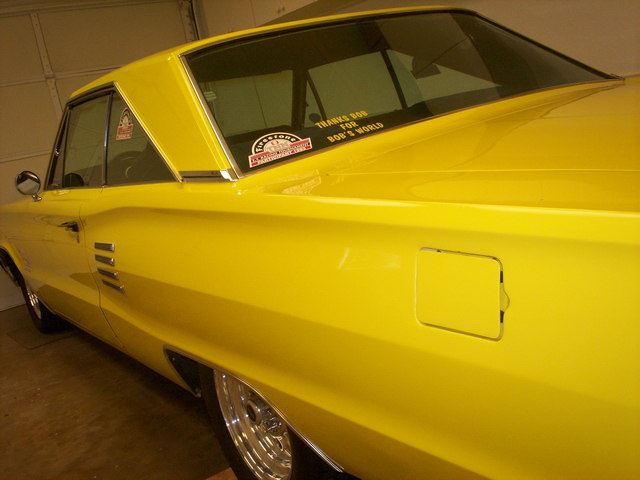

Well, that answers my question on if I should remove my rear window glass or not. As mentioned, it's the original glass and gasket and both are in excellent condition and do not leak, so I guess that I will just fight with the headliner to get it installed, rather than removing the rear glass. I do need to remove the front windshield though, as it's pitted after 43 years and I also need to remove my dashboard assembly to restore all of its parts and pieces and to give it a new coat of paint, so I will make SURE that I hire a glass company that understands what's involved on these older Mopars. I had a guy a few months ago that replaced the original windshield on my 1999 Ram Sport Quad Cab after a rock damaged it on the freeway and he did an excellent job on my truck. He also looked at my Coronet and said that he could do that work also, as he had quite a bit of experience on doing the older cars and knew how to make them not leak. I will just have them remove the windshield for now and then have them back to install the new glass after I complete all of the rest of the work I need to do on the interior. I also hope that they can match the factory color tint that all of the rest of my original factory glass has. Do you guy's see any problem with that?
