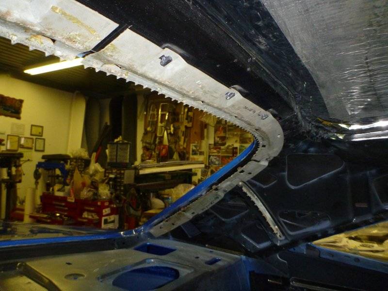

I’m getting ready to install the headliner in the 70 RR. I have the headliner and bows but I don’t have any of the clips. It looks like I need clips to hold the bows in place and the clips to hold the sheet metal “teeth” around the back window. Am I missing any?
Does anyone know where I could find them?

Look up Mega Parts, Coon Valley Wisconsin. if they don't have them they would know where to find them
Megaparts would have all the receptacle clips and the 2 rear wires, but I don't know if anyone is reproducing the plates with teeth.
Thanks. I’ll check them out. I have the plates with the teeth but nothing to attach them with.
So they know what you're after. The blackish looking lock tabs...

They attach to the rear most bow and are what holds everything in place when you start the headliner install.

I still can’t find the metal teeth plate retainers. Anyone have a source for those? Or what they’re called?
In the picture above it looks like there is a metal teeth strip running across the sail panel area. Is that correct for a 70 Road Runner? I don’t have those.
