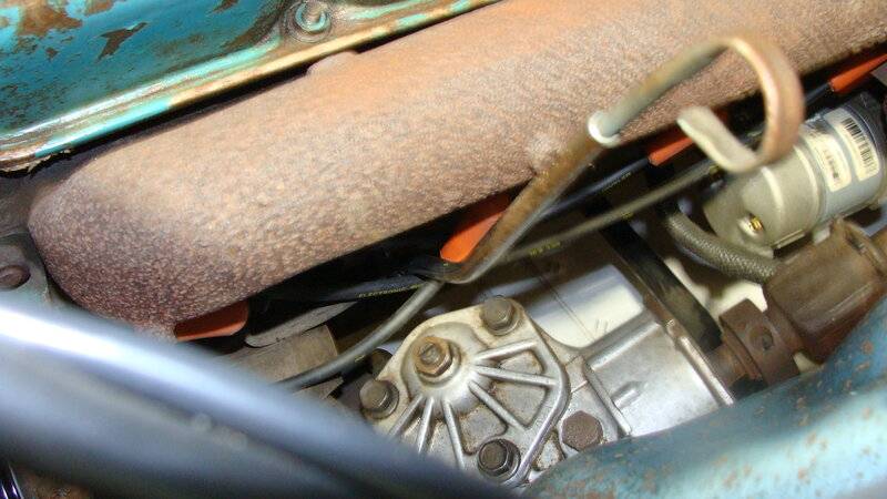

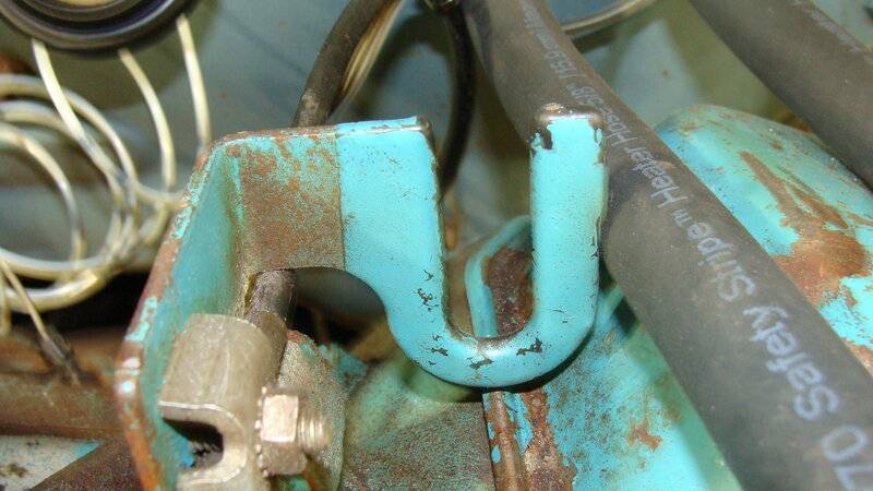

    Something intriguing to me in this photo is the body ground connection at the rear of intake. I always thought originally it was secured to the larger tapped hole in head above. Also does the throttle cable bracket U shaped portion for kickdown linkage on automatic cars appear to have been dipped in a rubberized like coating? I see traces of it under the turquoise paint. Thanks!

    Your torturing me with this photo!

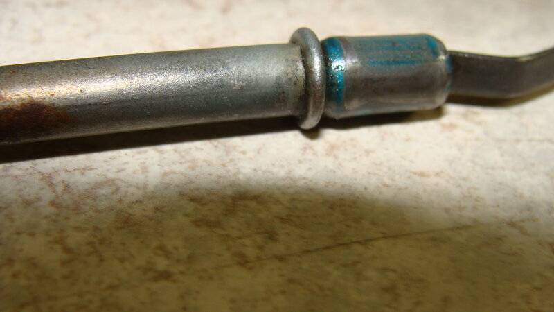

      Very nice..so oil dipstick handle was in fact painted.

      DSC05441.JPG DSC05413.JPG yes, rubber coated bracket

        That's what I think, although not much left, I'd think the paint dripped down. perhaps the tube/stick weren't put in at painting? alot can happen in 55 years.

          Every one I've ever seen in my 40+ yrs. of messing with the early big blocks that bracket is dipped in rubber, also the dip stick was painted! I've seen the tube painted and also bare with the end with overspray at the block end!

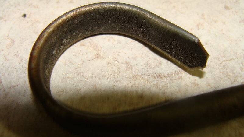

              Do the 3 heater box mounting nuts appear to have been yellow zinc dichromate or black zinc? Does the throttle cable hold down clamp appear not to have been painted?

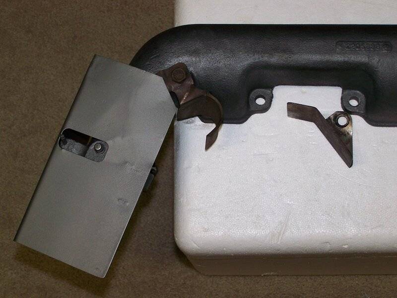

                That part in the pictures sure looks like the heat riser counter balance to me.
                • Agree Agree x 1
                • rarefish
                  rarefish Well-Known Member
                  Messages:
                  417
                  Likes Received:
                  226
                  Joined:
                  Jul 9, 2013
                  Location:
                  NY
                  Local Time:
                  5:17 PM
                  Here are a few pictures of the right side exhaust manifold and heat shields from my 1964 361 engine.
                  • Like Like x 1

                    Def diff between LH & RH. LH has one closed hole mounting tab where the RH are both open. Bend on one side is diff on both. This one from my 64 Sport Fury 426-S

                    So Rarefish your car had the half round shield on passenger side manifold as well as drivers side?
                  • GOLDMYN
                    GOLDMYN Well-Known Member
                    Messages:
                    263
                    Likes Received:
                    303
                    Joined:
                    Jun 17, 2011
                    Location:
                    chilton, wi
                    Local Time:
                    4:17 PM
                    yes
