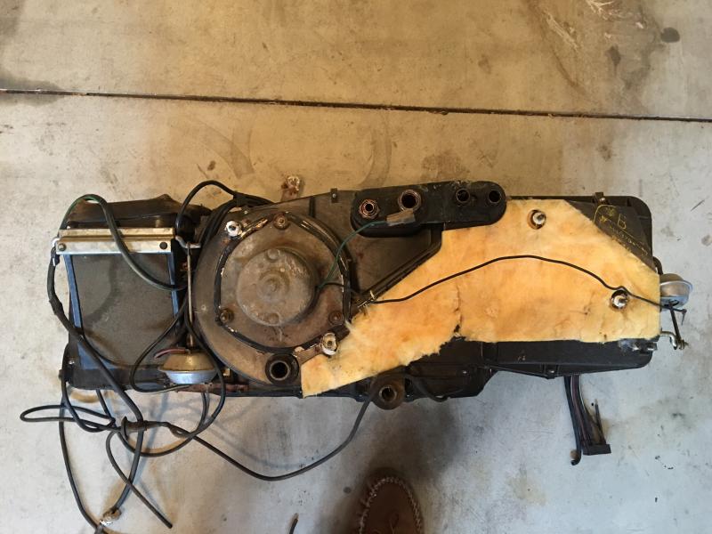

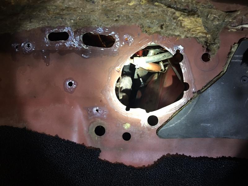

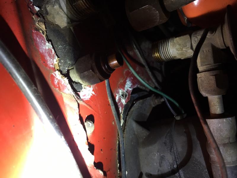

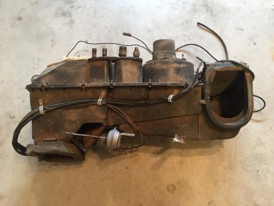

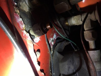

I pulled the whole dash to restore the dash pad and cluster. I figured I might as well pull the heater box too. I always thought something looked funny under the hood in that area. There was a lot of HVAC putty and it didn't look like the blower motor fit quite right. When I pulled the box, I FOUND THIS! Somebody cut the firewall to make this box fit, BUT WHY!? Can anybody out there help me make sense of this? hvac1.jpghvac2.jpghvac3.jpghvac4.jpghvac5.jpg
Just a guess but looks like was originally a non AC car that was cut to fit the AC unit.

Yep someone cut the wall for a/c. Can see part of the hole for the non-a/c fan.

Has far as the fire wall goes what car do you have? A GTX or RR I'd put it back with non-a/c. A Satellite then go with what you want. The best way to go would be to cut out the wall and weld in the proper patch for which ever box you use but that is a bit of work.

Right!!! The previous owner cut a hole in for the vent, doesn't look quite right. And, my car is a 71' Charger R/T. Should probably put it back to non-A/C then?

My suggestion if you want it to look neater than it is, would be to find a A/C car in a yard of your year and cut away the firewall in that area. Find someone who is VERY good at welding neatly and replace it.
