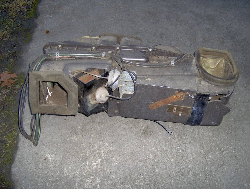

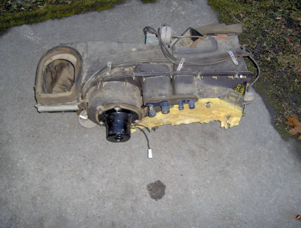

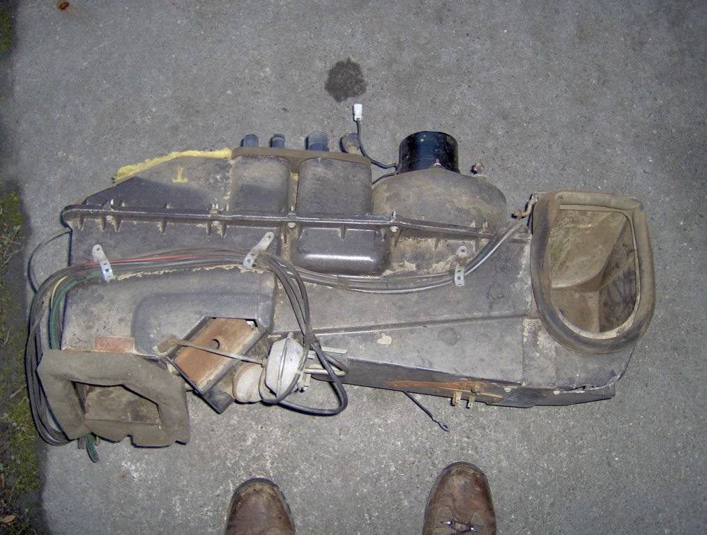

I have some pictures of my box when I bought it 5 years ago also. I will post them here along with some basic dimensions in the morning.
The AC box that I have is approx. 32" wide plus 2" for a vacuum module, approx. 12" high and approx. 12" deep plus the heat and AC pipes and fan motor that protrude through the firewall to engine bay. See attached lousy photos!
