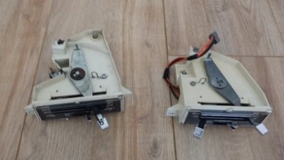

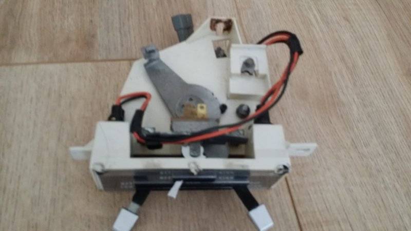

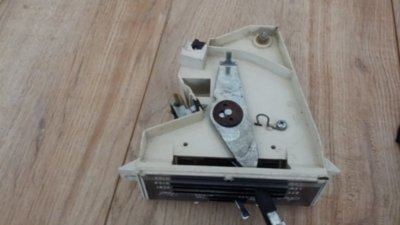

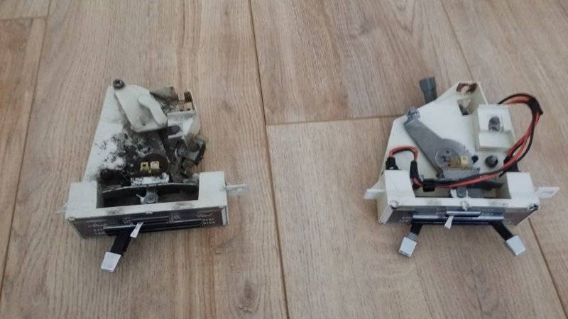

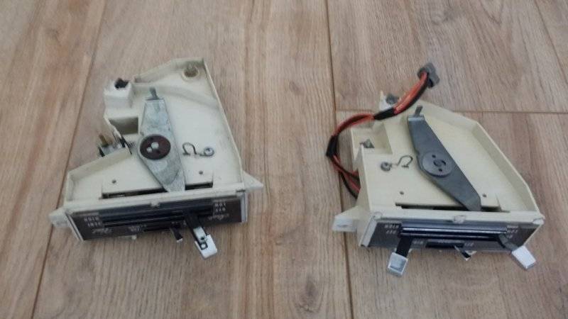

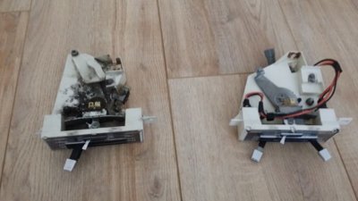

Hi there,
I recently replaced the heater control unit for my 1972 Dodge Coronet Wagon. The unit i had cracked at a mounting point and had some more cracks in the plastic, so i decided to replace it. The one i got as a replacement is a bit different though, i have added a few pictures in the thread as well. As you can see the mechanisms for pulling the cord are a bit different, and the old one (mine) also has some thing with a few vacuum lines.
I have added a few pictures of the units. the left one is the one i had in the car.
Does anyone know if i can replace one with the other, and what that vacume line thing is for?
regards. Willem
20190628_103111.jpg 20190628_103116.jpg 20190628_103122.jpg 20190628_103137.jpg 20190628_103140.jpg 20190628_103144.jpg
vacuum switch is so when you go to full cold vacuum is applied to the heater core shut of valve under the hood to stop coolant from flowing to the heater core.
