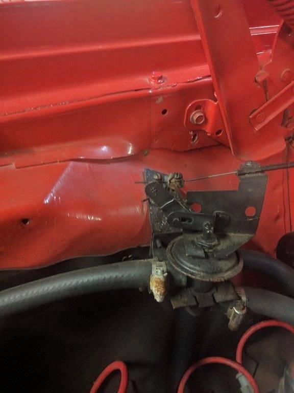

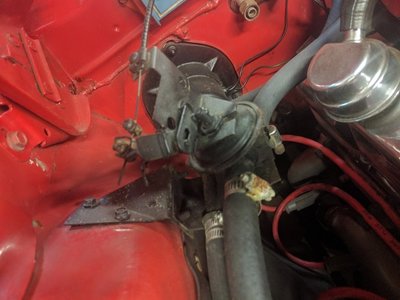

Hi and thanks for the help. My heater control valve is leaking by making the cab hot. The fourseasons valve doesn't mount right and just looks out of wack in general. But I am not sure that what is on the car is right either? Any ideas and hook ups to buy the part is appreciated. Thanks Jay

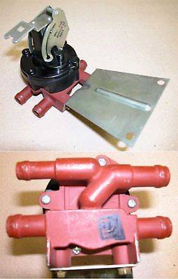

My 73 Charger had the same valve on it. I believe the original ones were these (pictured). But due to cracking and general failures they were changed out for the one you have.

Which way would you go? The cable is not connected right on the valve I have and I don't think I have the hardware to connect it right to either one of these really? I don't see where I can by the parts and pieces either?

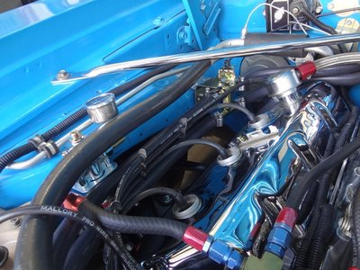

I bought mine at Rockauto.com. It's the same that you have now. Mine works great on my 73 RR GTX.

The cable is straight, how did you get it to connect to the pin?
I used needle nose pliers and bent a loop around the pin. I made it a press fit around the pin. It stays put.
Just a note that they are different A/C and non A/C.
