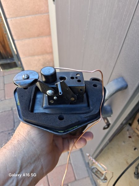

Bought this at a swap meet years ago for a spare, thinking it will be correct for my 69 charger. But its not the same. Thanks in advance, Tony.

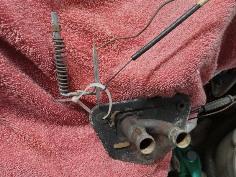

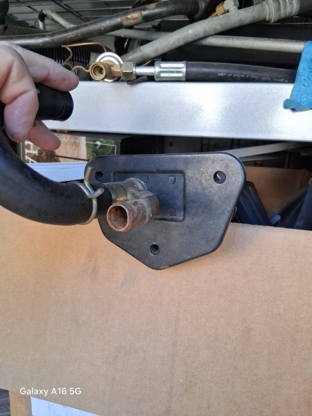

It should be the same as your 1969. How about a photo of what's in your Charger?

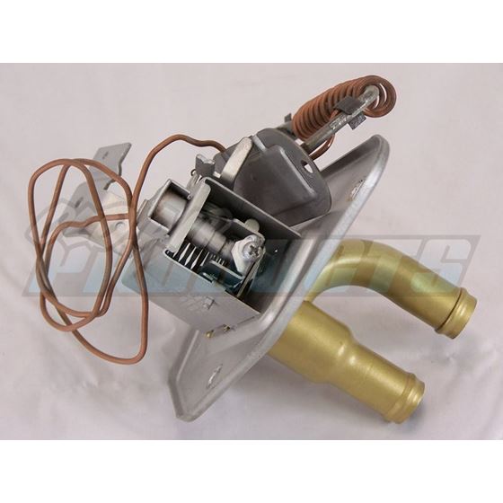

Heater Valve, Thermostatic 25-4636
Old Air Products​
25-4636 - Heater Valve​
1968-1969 Dodge models w/ Factory A/C, w/ Thermostatic Valve, Core may be Required​

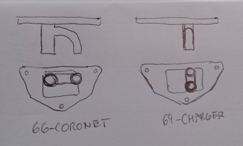

How the valve operates is different between 66-67 versus 68-69
This is 66-67
Lever is shown in open position
68-69 would be closed position
