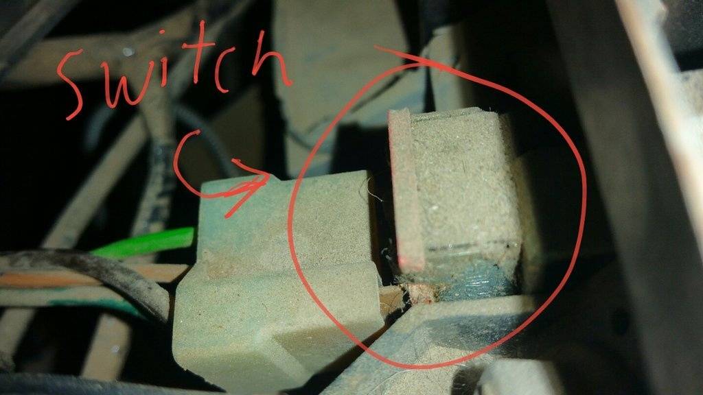

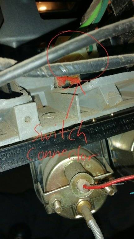

usually the high side of the fan switch will melt, sometimes I've had the switch go bad, but sometime the plug to the switch will melt. other models used the same switch, vans, cars from the '80s to the early '90s.

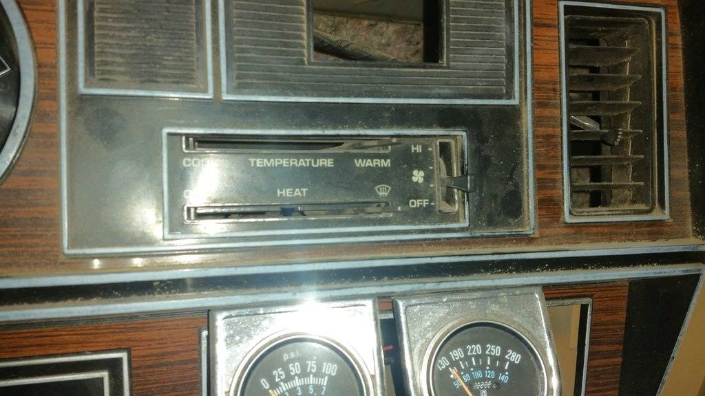

I believe it's black. I'll go take some pictures and post them here.
Ok here's the switch.
