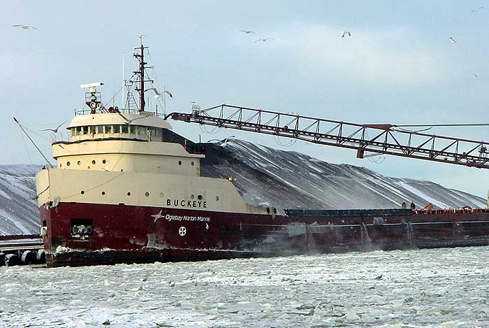

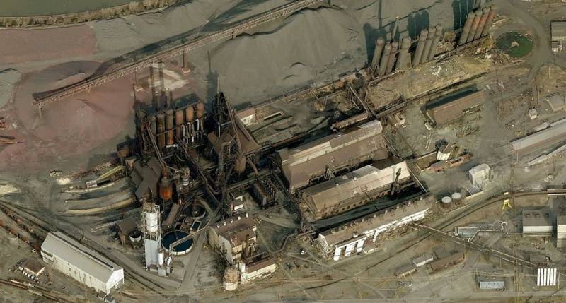

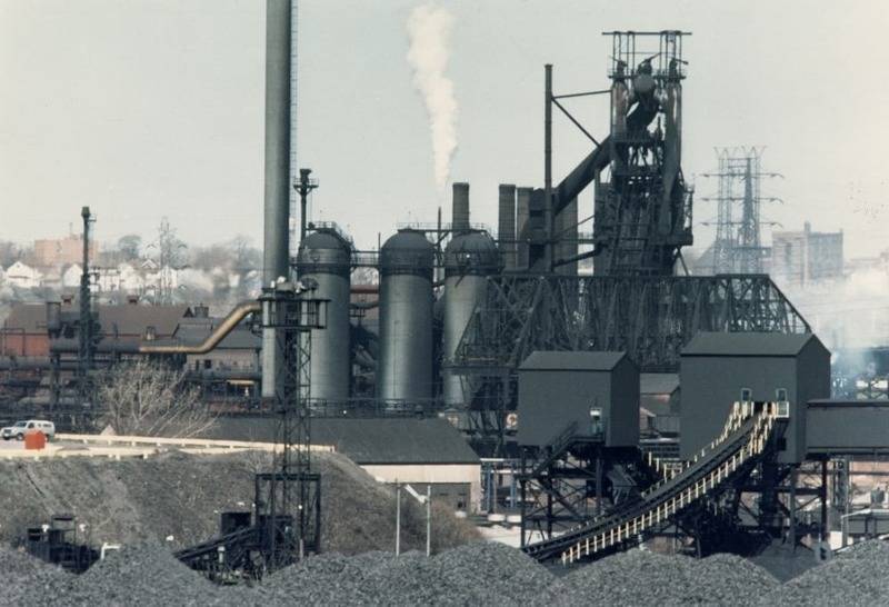

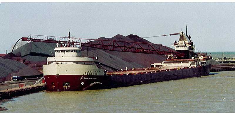

Cleveland Republic Steel and Lorain USS Steel in Ohio Cleveland
and Lorain
and was a Heavy Equipment operator on a large dozer on those pellet piles
boy the wind chill BRRRRRRRRRRRRRRRRRRRRRRRRRRRRRRRRRRRRRRR no heater or cab
