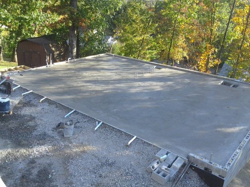

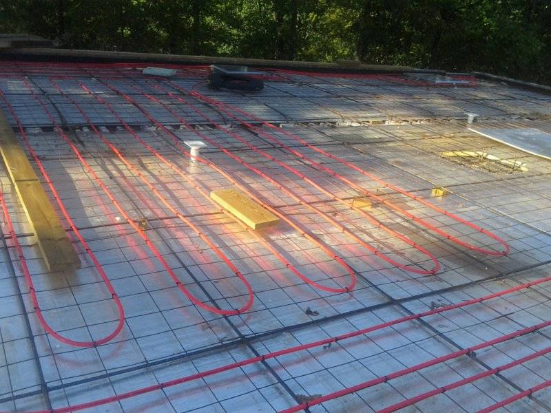

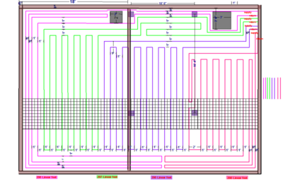

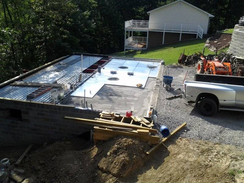

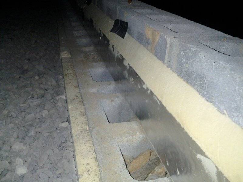

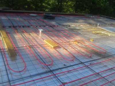

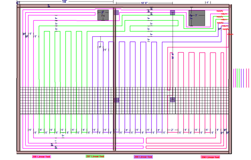

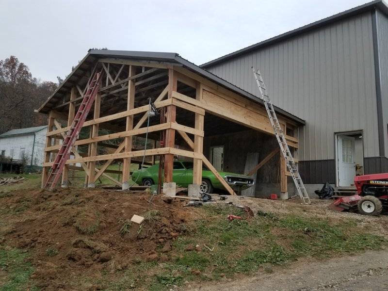

                            Devon if you decide what you want to do let me know...I can draw up the in-floor schematic for the tubing...I used the 6" wire mesh in my concrete pour and tied everything for the floor onto it.
                            Nice thing is if you make an actual accurate diagram of what your going to install and then install it that way you always know pretty much where they are in the floor in case you ever wanted to attach something else to the concrete...
                            Here's what I used...my runs were 300' long each...with a total of 4 runs...I concentrated the perimeters closer together as that is where the main heat loss takes place and then spread them apart further in the center of the slab...
                            Depending on the size you may be able to get away with 2 300' runs which would mean you only need a manifold for 2 connections...
                            My slab was 28x40 but the inside dimensions were more like 26x38 due to the 12" block walls...
                            Along with insulation under the slab you will also want to insulate the side of the block or footer to prevent heat loss through the end of the slabs...
                            No progress on mine in a while...I'd like to get everything for the heat finished up before this winter...
                            Let me know as it does take a while to draw everything out and then move it around to get equal lengths....
                            I have no formal design experience for this as I just copied a floor plan that was used on a commercial project I was working on...then tweaked that around to make it work for what I needed...

                              I appreciate the help, I started another thread to gather thoughts and posted my preliminary plans lol. As for my layout it's extremely simple, a 24x24 with a 16' garage door centered on one wall. I saw some routing plans that I'll post once I have a better connection but it's basically a spiral layout. One run will run around the complete perimeter spiralling back to the center where in returns then the next just inside of in then another?

                              I drew up a quick schematic but after thinking about it I know it is wrong...You are attached to the existing shop on one wall...that would mean you could lessen the frequency of the runs in the floor in that area being as the loss is much less...I was told not to get runs greater than 300' using the 3/4" pex piping... After drawing it out I'm pushing 300' on two runs and end up with an 8x8 or so in the center with ho heating...
                              I was trying to do even runs with an even number of manifold connections...Just trying to avoid needing to buy a 4 connection manifold when you may only need 3...preferably only 2
                              I'll move it around a little and see what 600' of piping looks like with less heat along the existing shop wall...
                              If the foundation is a 6" block the interior dimensions change to 23x23 which also will change the length of the runs...
                              If you get a chance sketch me out something primitive but accurate and we'll see how it works out...
