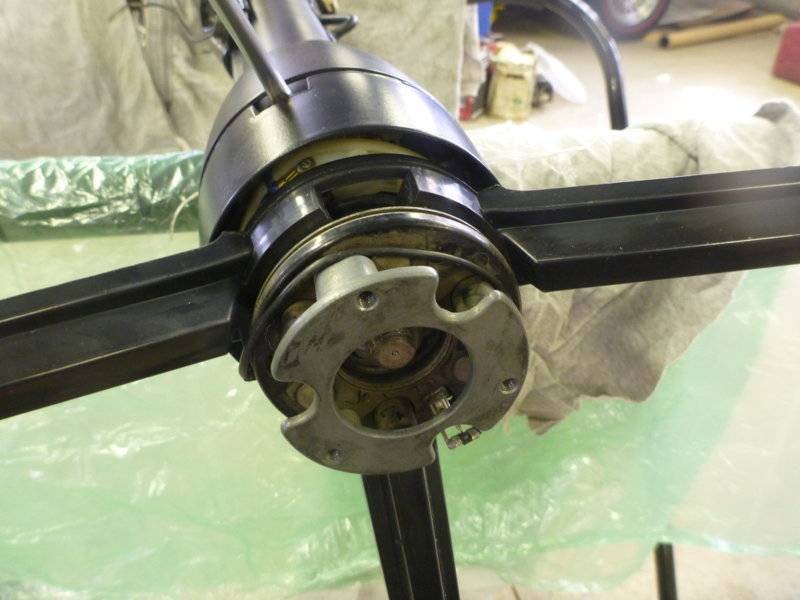

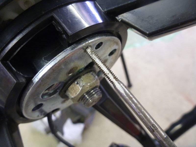

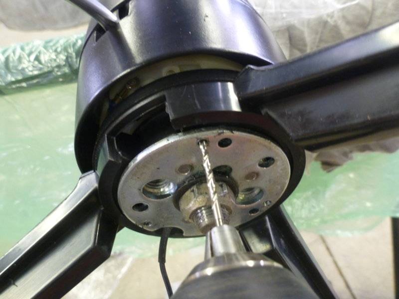

WHAT SIZE/TYPE OF FASTENER TO ATTACH TO STEERING WHEEL ,,,HORN CONTACT IS ON THE RING JUST NEED TO PUT IT ON THE WHEEL ,,,,,,THANKS TO ALL
Answered you on DC ... OE wheel is 6/32 and reproductions are metric for obvious dumb reasons! Easily retapped at 6-32 and I also found you need to remove plastic from behind the hole on reproductions.
