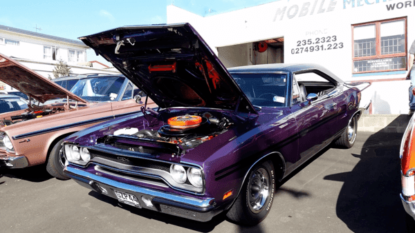

I have 295x50x15 on the Rallye wheel 15x8 with standard offset on my '70 GTX - probably exactly the same wheel house clearance as yours. No issues at all....except a telltale rub mark up the top when some fat bastards sat in the back. :D
