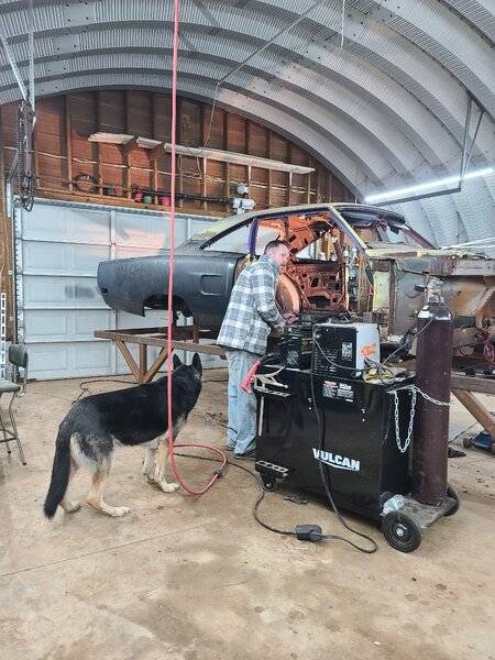

this is me working on my heap. I have all new floors,quarters, taillight panel. I also have really good fenders( I actually have 2 pairs). I only have the quarters tacked in place, I think they will have to come off since they go all the way into the rear glass frame. When I go out to my shop I'll take a pic of what my rear glass frame looks like. It is a dang nightmare, having an issue that just brings you to a complete halt
