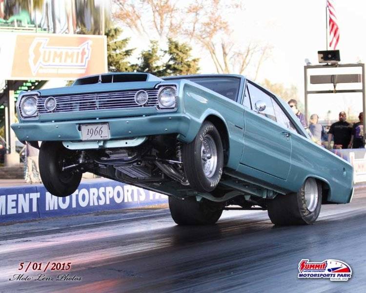

Mike a buddy runs a 604 B1 headed motor on alky and dynoed at 1008hp cant remember tq car has run best of 8.79 in a 66 belvedere with a glide car weighs under 3000# motor is all aluminum haven't got it totally tuned in yet.Not sure of all specifics of engine.Hope that gives you a little insight.He races at Norwalk ,Oh summit raceway

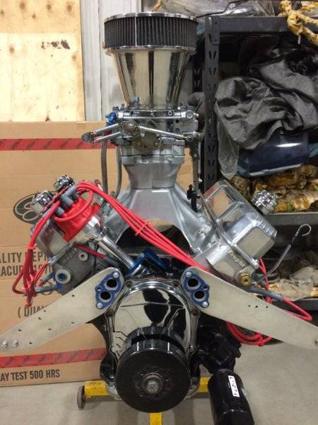

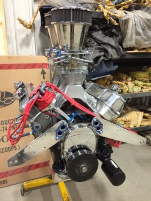

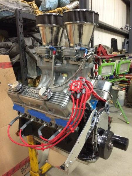

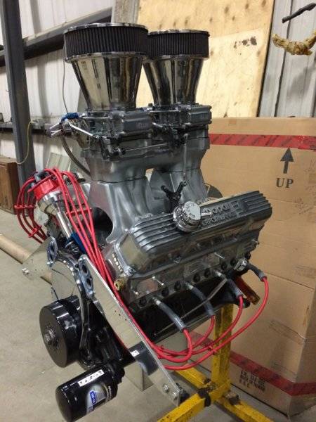

9.60 would be more attainable in a lower maintenance piece. I have been 9.490 at 139.99 with my 540 and at 3580lbs.
My combo is not exotic at all.
540
indy aluminum block
4.5 stroke crank
4.375 bore diamond shelf piston
13.5-14 to 1 comp
Indy 440-1 345 cnc heads
T&D rockers
683/683 roller with 284/288 duration easy on valvetrain parts
727 with an ATI 8 inch converter
dana with 4.10
weighs 3580
Indy modman and 2 edelbrock carburetors
At your weight you would have a good 9.60 car without a lot of maintenance and likely a better induction system.
