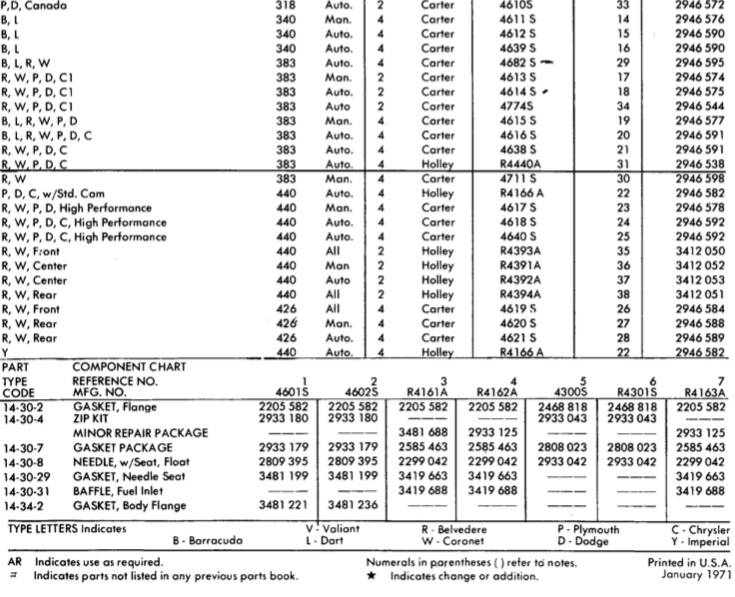

So do you think '69 Plymouth RoadRunners started with Carter carbs and switched to Holley carbs mid-year or vice-versa? Or do you think this might have been a regional deal where the Midwest plants got Carter carbs and the west coast cars received Holley carbs? Something is missing here...

The 1969 charger/Coronet/Dart service manual doesn’t show any Holley 4 bbl carbs. That parts book page above shows the 4440 for RWPDC. Possible a typo? The Galen white book shows the same. It’s the only Holley they show for a b body.

Note that the Holley is listed as auto tranny only so while I don't have an answer to the question it shouldn't matter in regards to your car.
Nate, the chart you posted looks like it was for '70 vehicles based on the print date. Just say'in.
That chart is full of 1969 Only part numbers. There are no 1970 carbs listed.
