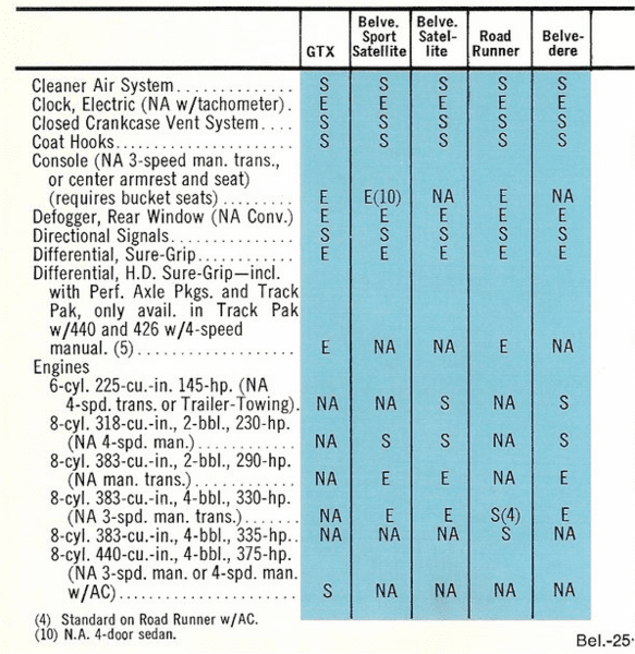

It also appears that you couldn’t get A/C with the manual transmission.
I see that for the GTX but not the Roadrunner.
Here's where you don't get the Roadrunner engine in a Roadrunner with AC.
Guys, remind me, what is the difference between a 330 Hp 383 and a 335 HP 383.

That chart is full of 1969 Only part numbers. There are no 1970 carbs listed.

My experience here is with SuperBee's, but I think information would also apply to RoadRunners. The orange 335 h.p. 383's got a Carter AVS, but the turquoise 330 h.p. 383's got a Holley. A/C-equipped 'Bee's got the 330 h.p. motor with a Holley. Regular Coronets mostly got the turquoise 330 h.p. motor with a Holley. If someone knew what he was doing, the orange 335 h.p. motor could be special ordered in a regular Coronet. I once found the remains of what was almost a SuperBee convertible in a local junkyard. Coronet 500 convertible, with bench seat, 4-speed, and orange 335 h.p. 383 with high performance exhaust manifolds. Difference between the two engines was the camshaft and addition of windage tray to orange engines. 335 h.p. engines with TorqueFlight also got higher stall converters. All 1968-1970 big block engines got "906" heads, whether high performance or not.

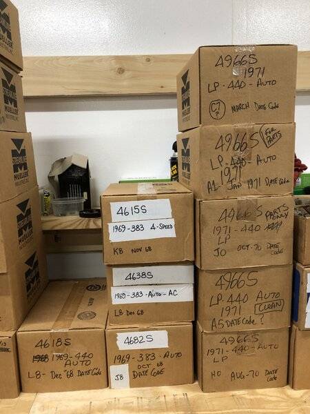

The parts manual says that the 4-speed gets the other Carter. That auto looks like it got the Holley sometimes.

The 1969 charger/Coronet/Dart service manual doesn’t show any Holley 4 bbl carbs. That parts book page above shows the 4440 for RWPDC. Possible a typo? The Galen white book shows the same. It’s the only Holley they show for a b body.
I’ve never seen a 1969 roadrunner/Bee with a Holley carb. I’ve only seen them on low horsepower 440 only in full size cars.
