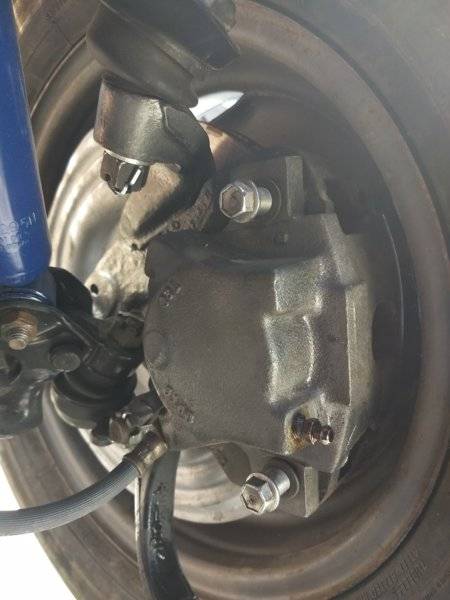

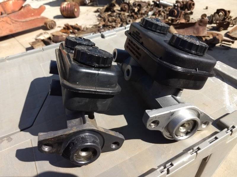

I'm sure this has been worn out but I can't find it here so...66 Coronet with single resivour MC. Got a set of 71& up b n E body brakes, I have both large and small Master Cylinders and both bypass the front brakes. I did put a 68/69 style junction block. I've been told I need to add a perportion valve?
Any help is appreciated

In your second picture I suggest swapping sides on the calipers. You have the bleeders at the bottom and you will never be able to get the air out of the system.. Bleeds need to be at the top of the caliper..
Hey Beep beep.....I owe you a beer! Swapped the caliper's, bled them and finally have pedal!! Thanks!! I would appreciate info on if I really need that proportion valve is needed? Or is the 68/69 dual master cylinder junction block is the same?
Unless you added them afterwards you are missing the caliper positioning springs/clips.
They go on the caliper pin bolts.

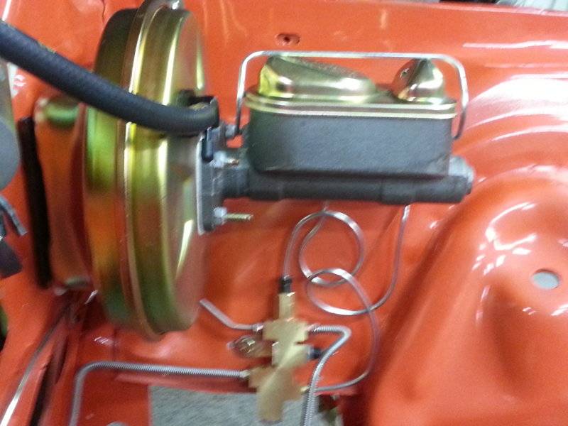

Cass is a stand up guy and highly recommended. He knows his stuff and well known. He might just be "out of the office" due to the virus thing. Here is the proportioning valve from him and used on many years, sorry for the blur picture. Cheers
