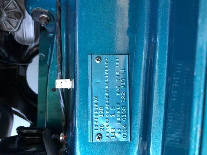

Can anyone help me with this fender tag off of a 64 Belvedere.
This is just my opinion, but that fender tag looks a bit too nice for a car that old. I would want a lot more documantation than that tag if I was interested in buying it. Having said that, Iwill give it a shot.This is according to the info that I have. 0114 scheduled production date Jan 14-1964. 0108 shipping order number. 322 Belvedere two door hardtop. M1Q turquoise bench seat.LL dark turquoise metalic paint. The following applies to the lynch road plant, and possibly others but not Hamtramck. 14- 426 street wedge. 3- four speed trans. 1 - am radio. 5- heater with defroster. I don't know what the other numbers mean. The fourth digit of the VIN would be a 1 if it is a lynch road car. If that is an original tag, I would also check the body codes to make sure they match the SO number on the tag.

I just couldn’t find a decoder that would confirm the 426 and 4 speed.

You won't find a decoder for '65 and older. Online decoders are for the newer vehicles.

KENTON - ever figure out the decoding of line 1?

GG book has the information for those cars.
