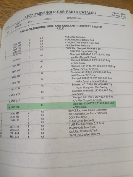

I need help finding out what year and vehicle model my radiator is #4016971 and also has 18398 on it. any help greatly appreciated. 1970 Roadrunner with 383 magnum but PO swapped this radiator into it Thanks

Newer than 74. My book goes to 74 and the numbers stop at 369****

I always have googling Mopar and then number for info. My 2cents just shy of a master parts manual

That is a 28" radiator from a 1977 C-body with 400/440 engine and max cooling.
