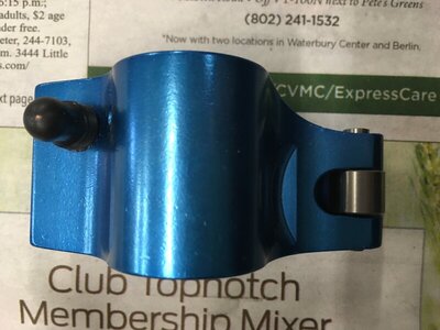

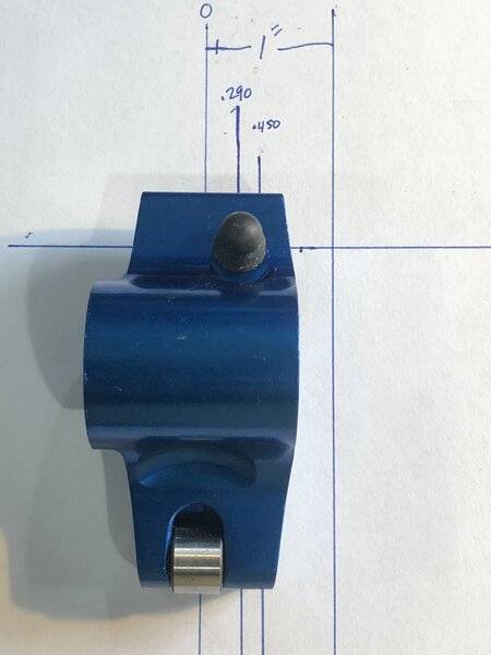

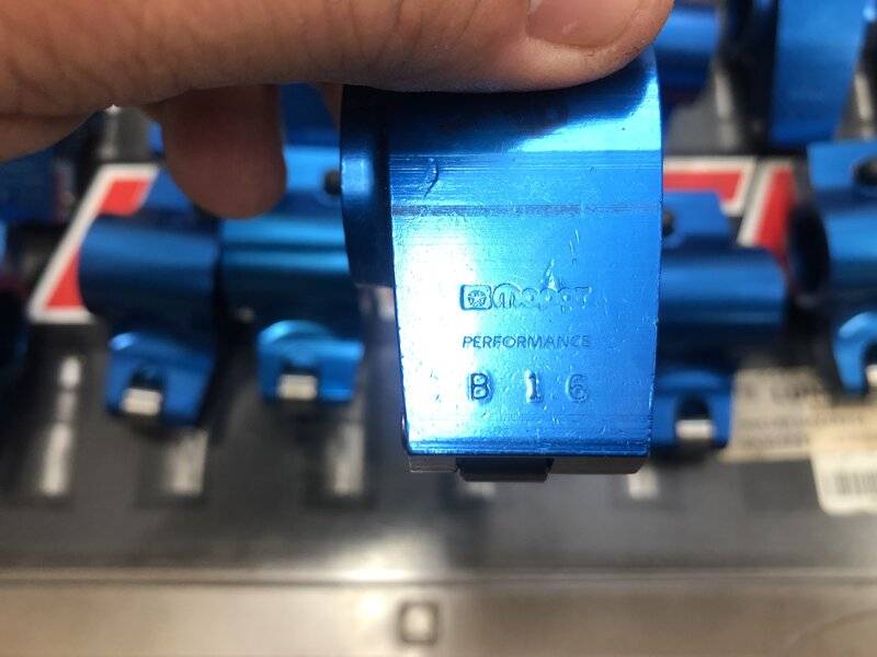

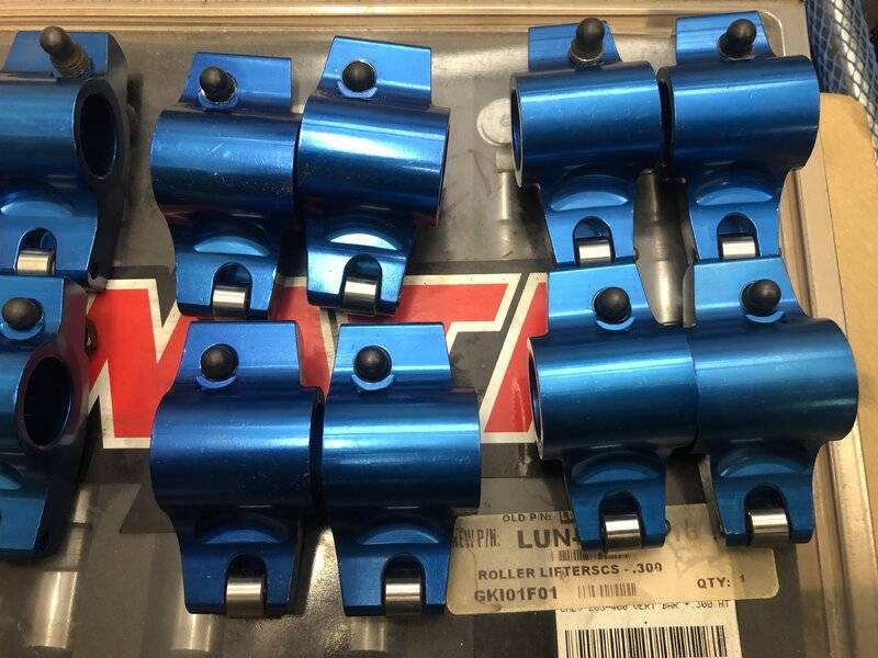

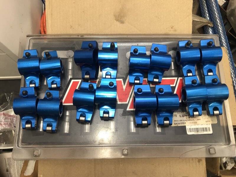

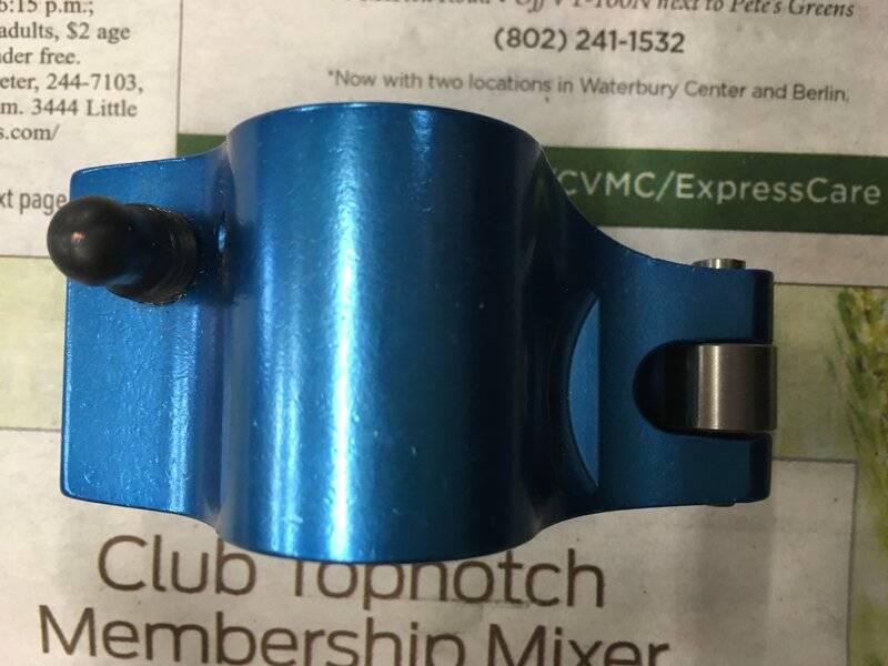

Thanks for the help. Here are the Pics. Hope this helps. They are kind of uniques with offset adjuster and roller.
good find on the Russian site. At least it says big block.
Generally I’ve found that exhaust rockers are the same Indy, Eddy, OEM, stage 6.
Intakes have various offset.
I suspect I’ll measure offset.
Stage 6 .450-465
Eddy Victor .650
Indy .825
strangw that these part #’s are lost or they Got superseded or discontinued as soon as produced. Fiats MP performance line said discontinued 2005 so they may in print in 2003 or 2004 catalog

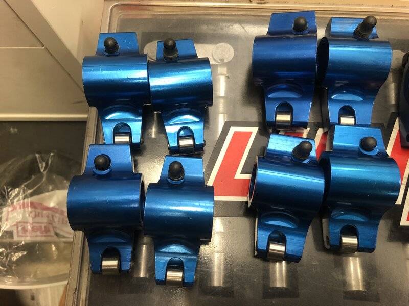

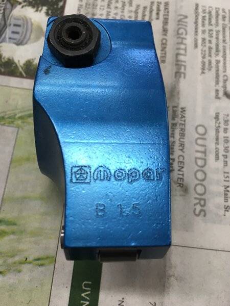

I wonder if those are something that was designed for use with the MW port Chapman stage 6’s.
The offset is measured from the center of the roller to the center of the adjuster.
I have 2 sets of the .485” offset intake rockers here(part numbers P4876438 & 39) that fit the non-Chapman stage 6 MW heads(P4876818 & P5249579) and they’re def not the same as what you have there.
DB556614-EB68-40C2-8478-CEA6B8BE1D88.jpeg DCA3607E-CA2D-479E-93F7-6E3762B50F36.jpeg
Maybe if someone had the instruction sheet that came with the MW Chapman stage 6’s, there might be mention of what rockers are recommended.

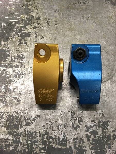

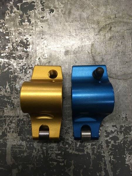

Crane sold a rocker set they advertised as for the stage 4,5,6, b1-bs, and Indy SR.
It had intake rockers with slightly more than the “normal” offset.
They are offset .290.
The thing is, Indy SR’s and non-MW(and non-Chapman) stage 6’s work fine with std rockers. No additional offset needed.
A little off topic, but it does help narrow down what you don’t have.
Crane “stage 4,5,6” rocker with .290 offset vs MP stage 6 MW rocker with .485 offset:

Quick measure solves it.
I was unaware of .290 offset heads.
Raced the Stage 6 MW ports with Harland Sharps in the Demon
