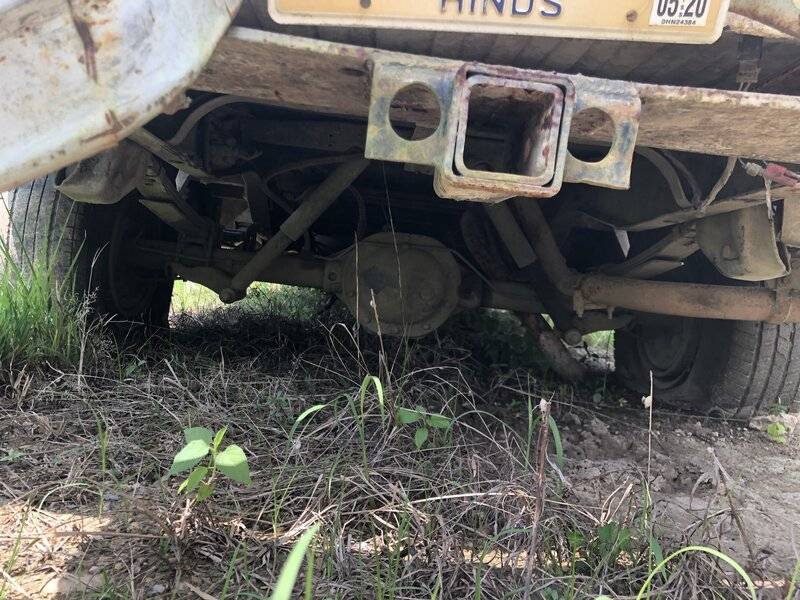

Its the picture of a 1989 D-150 1/2 ton pickup rear axle, the bolt pattern tells me that it's a Dana 60,
I have a 1970 R/T Charger with a 8.75 rear end, would like to upgrade to this axle but can't find any specs on it.
Thanks in advance for any information given.
Keep your 8-3/4 over this later model axle. The rear wheel/axle bearings don't even have races. They just ride on the axle shafts. I had one go out in my old 78 Dodge pickup, and replaced the whole rear end with an earlier 8-3/4. THAT was an upgrade!

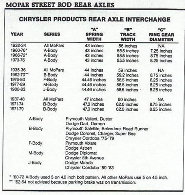

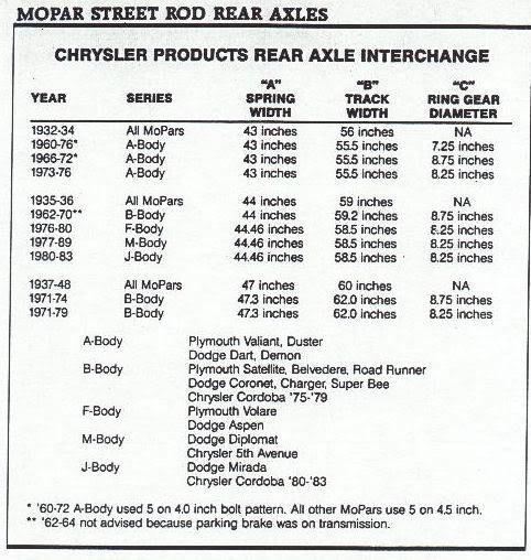

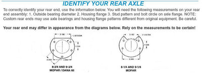

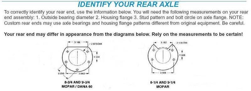

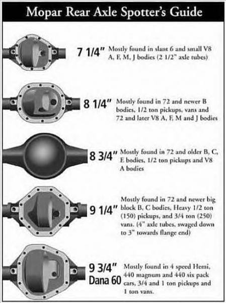

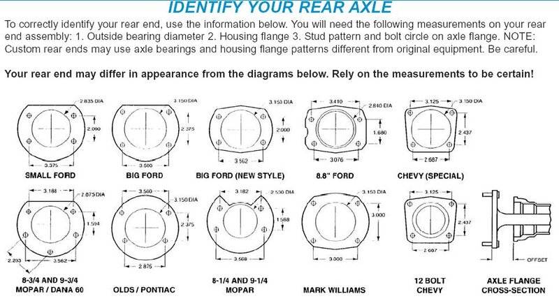

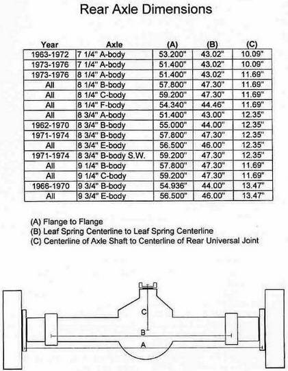

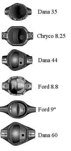

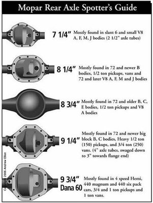

this should help if its a truck rear end i bet its s 8 3/8 or a 9 1/4 the lstrr id better than thre former but a dayna or a 8 3/4 is better .i like the8 3/4 its all cast iron
3.JPG 3257070182_large.jpg axlechart.jpg mopar_axle_sizes.jpg Mopar_rear_axle_dimensions.jpg mopar-rear-end-axle-flange-id.jpg rearaxle.jpg
