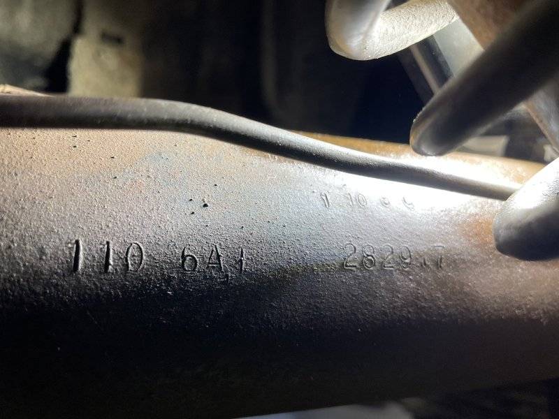

Hello, I have a Dana 60 in my 1966 Charger and need some help with the markings. All I can seem to find is 1968 and later information online. Is there any good literature I can purchase in regards to Dana 60 markings? I have attached photos. Thank you. The top is 1 10 6 C with 2829,7 below it and 110 6A1 to the left with a small symbol stamped lower right of the "A". The housing has 03 41 65 casting in it as well.
Looks like a typical 66 Dana 60 with 3:54 gears

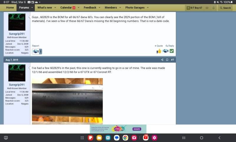

I have read that 602829 is the 66-67 mopar BOM number, but it seems the 60 is missing. Your dana should have a drain plug and 1330 U joints
