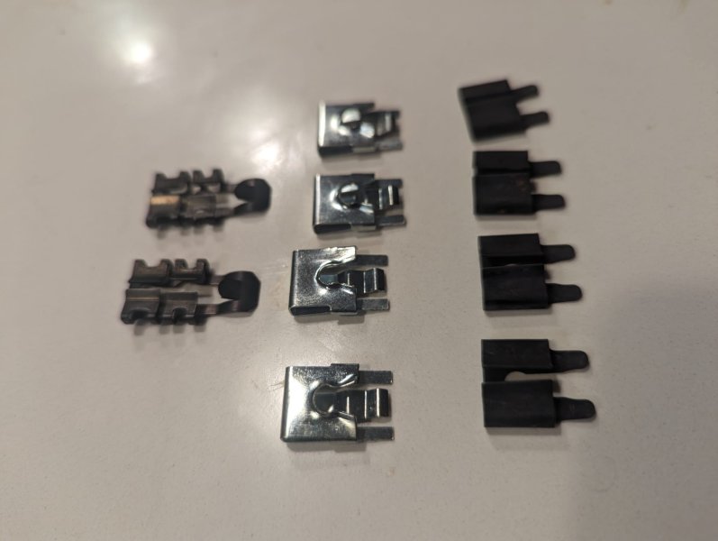

I've had an problem with the passenger door not opening from the oustide. I took the door card off and noted that the linkage clip had popped out. I squashed it a bit to tighten the spring effect and clipped it back on. It popped off again after a month.
I bought a new set of clips because when I tried to bend it again, it broke.
Can someone please look at the picture and tell me which is the correct clip for the passenger front door of a 69 Charger. Thanks
Hi Oz, I have the exact same problem, did you figure this out? I have the black clips on the right of your photo.
I bought new ones which didn't fit. I modified them with the dremel and took some meat out of the middle to capture the cusp. They have been good ever since
