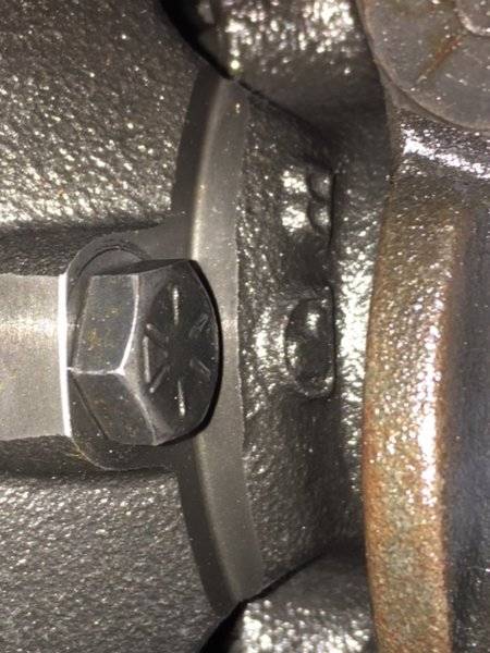

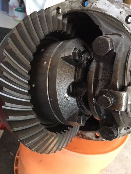

Hi guys,
Having trouble identifying which Sure Grip this is.
Picked it up on Craigslist but can't figure out which type.
Listed as a Detroit, but I don't think so.
Also, is there any way to test it before I install?
THANKS!!
I doesn't look like a clutch or cone type. Looks like a locker to me. Mine is in my car, or i could tell you for sure.
It looks exactly like pictures of a locker on gargle. Sale price $560 just for the locker.
Never messed with one but hear they make noise when turning....
Noise turning is the ratcheting of the clutch... Doesn’t make any noise if you give it a little gas... Well Ok, it locks so one tire has to slip so really the is noise... Just not from the differential..:lol:
If you want to call that thing a clutch lol
yes Detroit Locker -- keep it --- best unit out there for a serious street driven car -- you should have no noise when turning as this is the updated unit called a Soft Locker as denoted with the S in the part number -- works the same 100% lock up but a lot quieter than the old units.
i've built a few for fellows and they really like them.
as far as a bench check -- lock one of you axles in a vice and slide the unit over the splines ,, install the other axle in the other side and rotate it in either direction and you should here a ratcheting noise then rotate it back opposite of the initial direction and you should feel it lock up -- make sure the unit is oiled up internally to make this test go smooth.
Jegs shows them in stock, marked down a $100 to around $560. If you got that pumpkin for anything under $700, you stole it.
Then I am NOT going to share what I paid for it..
