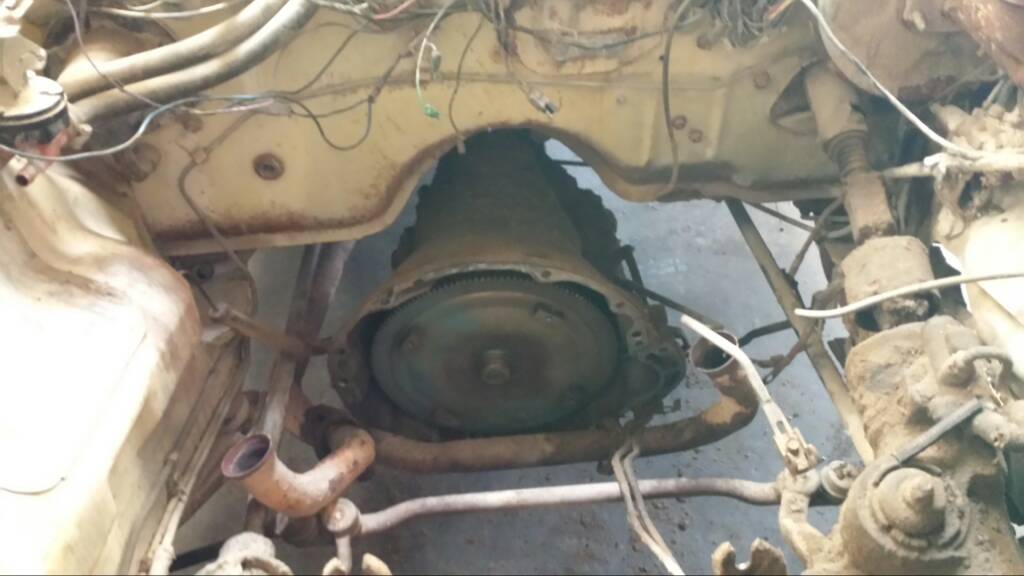

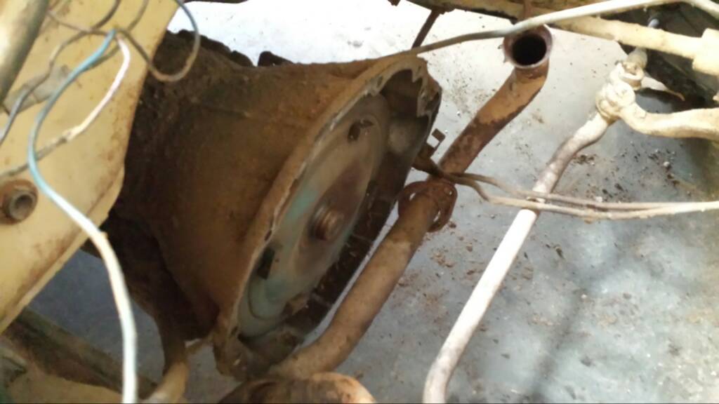

Car is a 1973 Charger hardtop. Original & current motor is a 318. Usually these would have 904 autos... but i suspect it may be an a-727? Seems awfully big for a 904. :/
. Thanks ahead for input! P.s. what are the easiest ways to tell which is which??? I can take and upload more pictures as necessary.[emoji780]
Crawl under the right side and look at the pan side rail. A 904 pan is straight, a 727 has a "big bump" sticking out
Your photos aren't very detailed I'm gonna guess 727
The main body behind the bell on a 727 is sort of tapered, a 904 is nearly straight

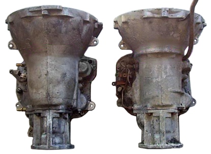

Showing bulge on right side of 727 pan
Below, 727 on left, 904 on right. Note bulge on pan right side of 727, and how case is sort of bulged and tapered

Below, yet another, 727 on left
