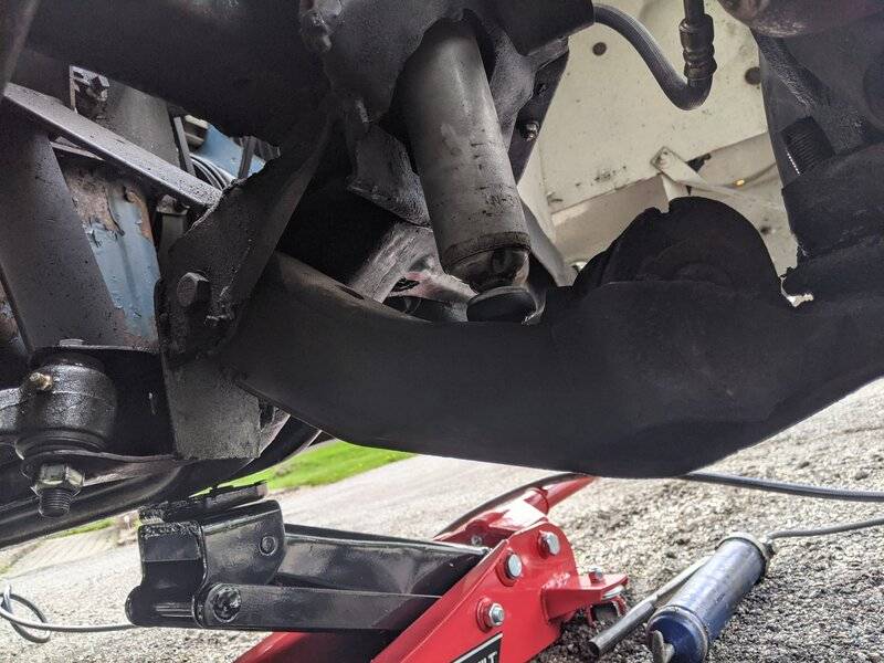

I have 1956 F100 with a K frame out of something dodge or chrysler and I'm looking to re-bush upper and lower control arms but can not figure out what year/make/model they come from. There is number stamps in both control arms.
Looks like a transverse bar suspension. Common in Aspen and Volare along with the Diplomat and other M-bodies.
I think they ran through 1988 on 5th Ave. and Dippy. I know guys up here that have this same setup under their mid '50's Ford pickups as well. My son put this setup under a 1959 Plymouth Savoy with front frame rails fabricated from 2" X 4" box tubing. You can buy everything you need for them from Rockauto.
