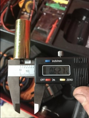

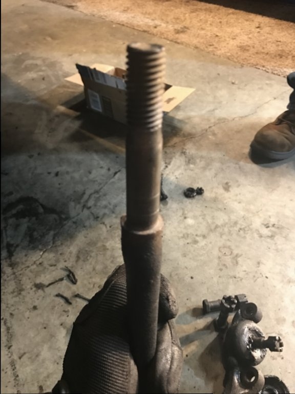

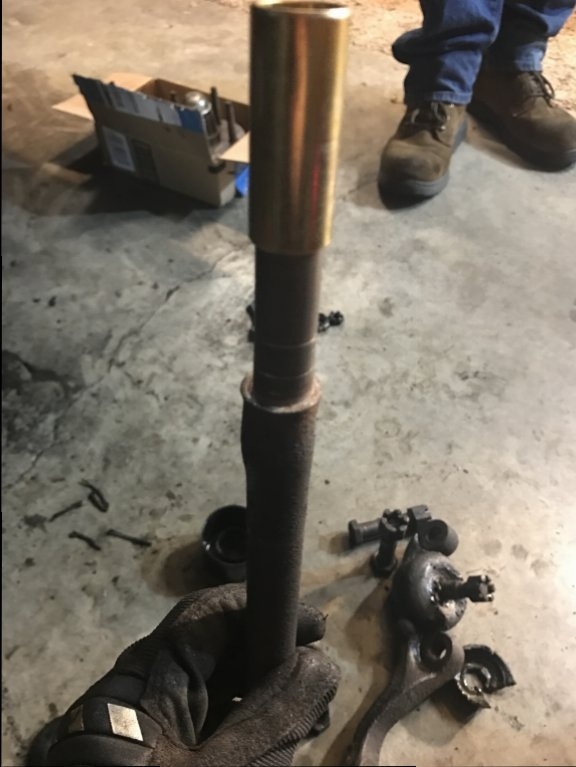

Ok guys, I'm installing the poly front end rebuild kit from PST on my 67, when I was installing the strut rod bushings i noticed the sleeve is really tight. The strut rod itself is tapered underneath the threads and the sleeve stops there. I mic'd it and the difference is only .020 but it seems tighter than it should is this normal? I just wanted to check with you guys before I smash it on. Also I destroyed one of my inner pivot shaft sleeves:BangHead:, where do I get a new set

Hard to see in the pictures but, is the strut rod really clean? Wirewheel that are and maybe run some scotch brite over it.

I didn't clean it off that well, I was just mocking it up and noticed how tight it was. I'll add that it was 2:30am I seen the fitment issue and called it a night. I'm going back to clean it up and see what it looks like then.

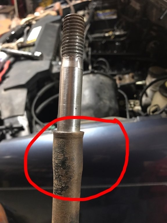

That's a potential spot for the strut rod to either wear or bend.
If it's worn, you can clean it up with a file (it can wear a groove and push metal to the sides).
If it's bent, buy a replacement.
I have slightly thicker replacements (from a member here).

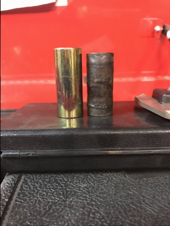

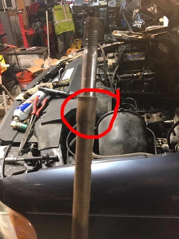

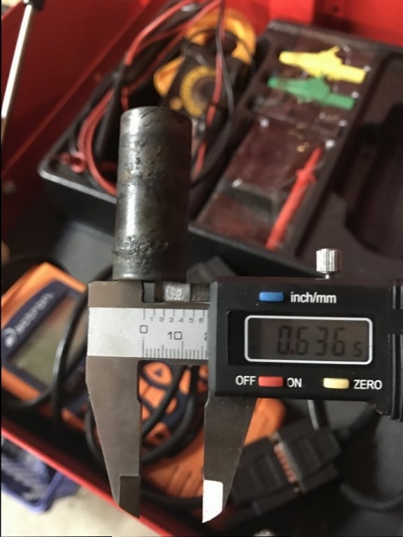

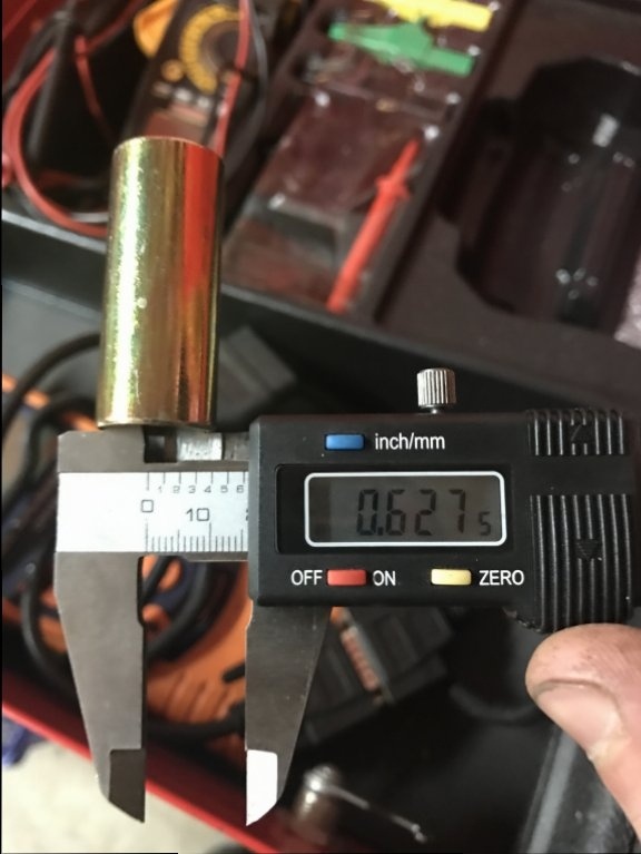

Ok this strut rod looks bad to me, let me know what you guys think. Also put a mic on the old sleeve and compared it to the new one, pretty big difference. What do you guys think?
That's pretty crazy, is that from a front end impact?
Does the sleeve fit now that the shaft is cleaned up? Keep in mind that sleeve is to limit compression of the bushings. Obviously it's got to fit over the shaft though.

Nope still doesn't fit, the other side was worse I didn't snap a picture but the whole rod is bent. I'm thinking maybe someone ran over a parking block or something because the bump stop on the drivers side was destroyed as well, you could see it took a hard impact.
I guess I'll be replacing the strut rods now...
