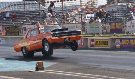

Here's what I have in my race car.
493 ci.
Roller cam-big
Indy SR. heads
727 trans.
4.56 rear gears.
No engine dyno numbers.
But chassis dyno shows 698 off the juice in high gear.
The converter is a 4000 rpm.

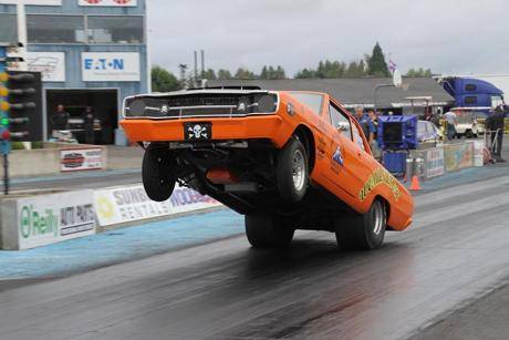

3900 rpm launch chip puts the car on the bumper.
I went to a 3600 chip and the car only rises 12-14 inch's at the launch.
I would be very careful about going to that big of a converter.
Alot of people go with too big of a stall or not enough gear.
Last Sunday we tried a 3000 rpm launch chip and the car bog'd bad and then went to the 3600 the next pass.
3900 chip.
3600 chip.
Hope this helps.

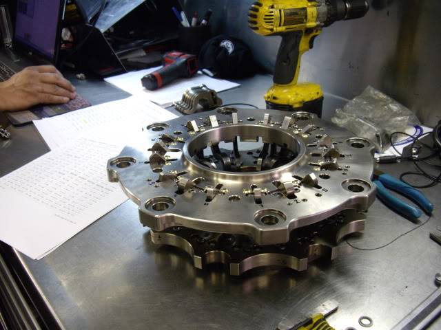

Wasn't trying to get in a disagreement here,but no one asked the right question.
When I was running fast,we weren't worried about flash speed .torque ratio and slip.
We were worried about how much clutch engaged on the hit and how soon the clutch would fully engage.
It's always smart to ask questions.
As far as my flash point go's I just called Coan and gave them my combo and they told me not to use over a 4000 rpm chip to launch.
My car has gone a best of 8.98 at 153 mph but I have dialed it down to 9.60's to 70's because I have another driver and it's not as hard on the car.
I'm not able to race the car anymore and I still had sponsorship obligations to deal with.
Friends.
