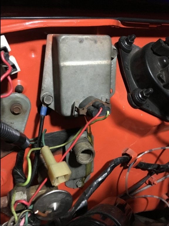

Hi,
I'm new to this forum and new to owning a classic car. I'm having an issue with 1970 roadrunner, engine is 1974 400 bb. When I go to start it, fires right up runs not even a full second the dies instantly. Carb is new and I had it dyno tuned when it was installed. It did this while they were tuning it and said possible ignition switch or tumbler. It stoppped acting up then and has been intermittent issue but would start up, now it's doesn't run. FYI I just installed a new ignition coil and it did run but it's back to doing it again.
(See photo) Also can anyone tell me what this part is? If you notice it seem like something inside of it has melted and is ozzing out. (the honey colored stuff at the bottom)
Thanks for any help it's greatly appreciated!!

That picture is your voltage regulator. The ozzing stuff is the filling that encases and seals the electronic parts. I'd replace that anyway. They aren't expensive.

These guys are right......99% sure it's the ballast resistor which is white, about 3" long and mounted on the firewall near the voltage regulator in your picture. '70 Road Runners should have a single ballast resistor & I "think" I see a double ballast resistor in the top/left corner of your picture.
Anyway, the ballast resistor drops the voltage from the ignition from 12-volts to 7-volts (?) before it goes into the ignition coil. That 12-volts comes from the ignition switch through the bulkhead disconnect (3 huge multi-wire plugs near master cylinder) via a BLUE wire going into the ballast resistor. When the car is running, a blue wire on the "out" side of the ballast resistor will be about 7-volts (?). ONLY WHILE CRANKING THE ENGINE, the ballast resistor is bypassed & the full 12-volts goes to the ignition coil on the "out" side of the ballast resistor coming out of the same bulkhead disconnect plug via a BROWN wire.
Basically, while the engine is cranking, the BROWN wire bypasses the ballast resistor and gives the ignition coil 12-volts. The second you let off the key (so it drops back from "start" to "run") after the engine is started, the BLUE wire continues to give the ignition coil 7-volts (?). When the ballast resistor burns out (super common), you get the 12-volts while cranking, but never get the 7-volts while running.....so the engine starts for 1 second & dies, starts for 1-second and dies, etc., etc.
Sounds like a ballast resistor to me. To troubleshoot you can jump it, temporarily, to see if it is indeed the issue. You just don't want to run with it that way for very long.

Would you take a picture of your ballast resistor? The wiring diagram shows a single resistor and yours appears to be a double resistor. Also, this whole thing would be a lot easier if you had a test light.
