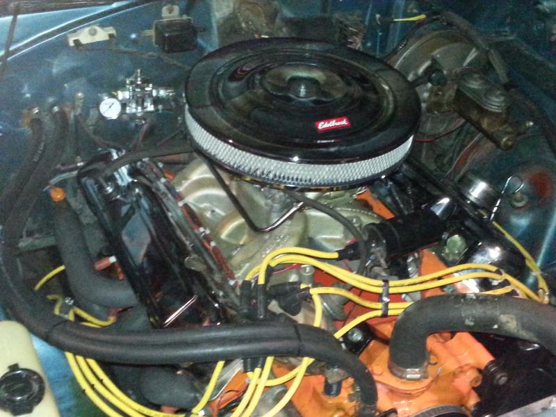

fresh rebuild 1968 383 Magnum .30 over 10.5-1 comp. Mildly aggressive cam
770 Holley, Edelbrock Performer intake, 1-7/8" headers, 2.5" exaust
It runs absolutely perfect.
within 12 miles I am at 230 degrees+
New 3 core alum. radiator with 2500 rpm fan and shroud
tried 3 different thermostats- 1 partial flow 165- no difference
tried 2 different water pumps- 1 SuperKool high flow- no difference
Bypassed the heater core- no difference, verified water flow to top of radiator thru the thermostat- it's coming thru and flowing after temp
have flushed and back flushed the motor. perfectly clear ( although when we first fired it up, I had a bit of rust come thru- motor sat for 3 years ) Possibly the rust got into the steam ports?
The head gaskets can only go on 1 way. Any ideas? What did I miss? Any help or suggestions would be greatly appreciated. Thank you!
