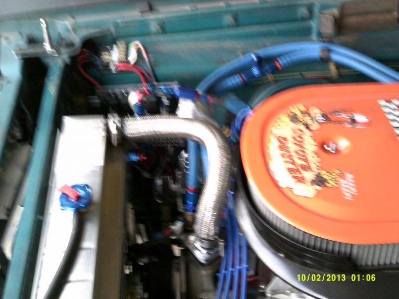

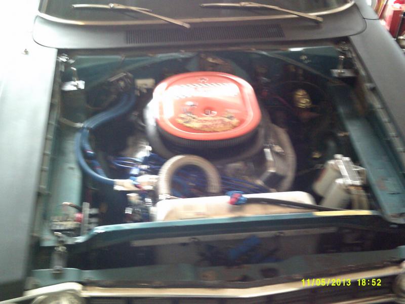

By the looks of your orig. picture you aren't running a shroud. I'd get a shroud, a 7 blade flex fan and a 160* thermostat on it. Even if this isn't the whole problem, It's critical you get that air pulled through the core. Also not a big fan of aluminum radiators, but thats just me. Can we assume it has a new Mopar water pump and not a cheap import knock off. It may very well be a combination of things.

Could there be air being sucked into the system. Restriction in the exhaust. Dosen't the temprature sensor use the engine for ground. So if you have thread sealant on all the threads it won't make a good ground and cause issues
assuming the seller was honest I would say you need to go back and recheck the camshaft install and make sure that you accurately check for top dead center with a degree wheel and don't rely on the balancer marks. If it was running good and not overheating before the cam change I would look there first. The fan/shroud really doesn't matter once your rolling the airrflow from the car moving should be enough to keep it cool.
Here is what i would do. First thing is to hook heater core back up. Then I would fill the system. Running the engine with the rad cap off till the t-stat opens. With the system full and the engine idling you can feel the upper and lower hoses. They will be hot. Air being pulled through the radiator will be hot too. You should be able to feel the obvious change in temp of the air and hoses when the stat opens. If all this checks out and the temperature is ok then I go for a ride. If the temp starts to creep up when driving then turn the heater on. That should help dissipate heat. If the air from the heater is not hot you either have circulation issues, a blockage, or an air pocket. Typically what you will see with a head gasket leaking compression into the cooling system will be wild fluctuations in temperature. It will go high, then come way down and then go back up. And coolant will be pushed out. How is the rad cap btw?
what kind of temp gauge? If not using a manual, get one, if just for piece of mind.
I would do as Hemi Rebel asked. One time I had a similar problem when I built a nice 383HP and dropped it in a 77 Cordoba. I went through everything as have you, but the first thing I replaced was the radiator. Nothing fixed it. I was so angry that I pulled the engine and replaced it with a nice street able 440 that I had also just built. Even after replacing the ENGINE, it still got way too hot. In desperation, I pulled the radiator back out and took it to a radiator repair shop.
Come to find out that most of the lower core openings were soldered over and wouldn't let the coolant flow properly. Never in a million years would I have expected a NEW radiator to be defective, but it was. It was never visible until the lower radiator tank was removed.
Never think that just because something is new that it will always be "good".
Hope this helps.
Please keep us posted.
when I worked at the IH dealership, we went thru boxes of "New" starters and alternators to find a good one.
Another problem I once had was with a new water pump. At room temperature, the impeller was tight. Once heated to operating temperature the impeller expanded just enough to slip on the shaft while trying to push the coolant through the system.
This was another once in a million chance. I replaced the water pump under warranty and problem solved. It was another classic case of a bad "new" part.
I read a thread about the water pump housing being too restrictive causing major overheating.. Don't know if you're running an aftermarket housing or not.
