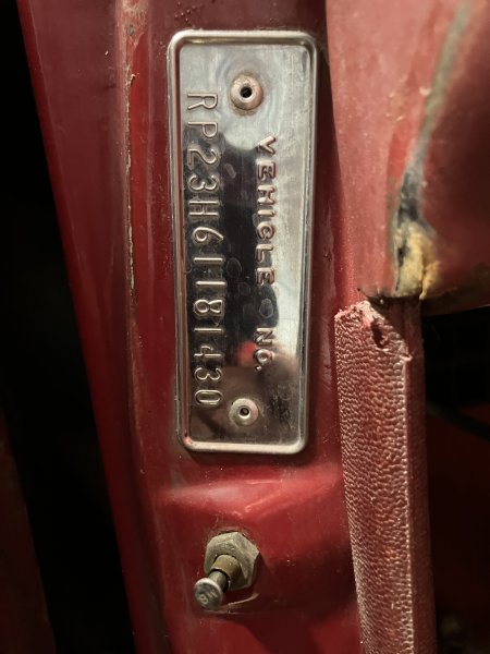

Looking for any information at all on a 1966 Red Hemi Satellite.
Does anyone recognize? Thanks.

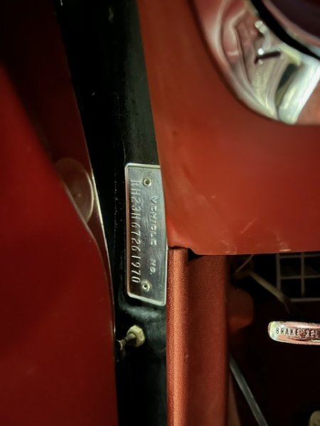

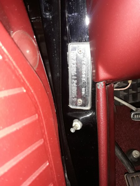

The round head rivets are interesting. Mine was the same and I "corrected" it to scalped heads... maybe I shouldn't have! LOL
Looks like mine had the scalped heads ...Been that way since the 80s
Mine are rosette
April 66 SBD
As far as I know, Its never been off the car

Well, it’s badged HP2 but still trying to find and validate the block assembly date.
The data tag SO is C1702131 Dec 17 ‘65.
Do the revits shape on mine indicate probably original tag? Or not?
I would say they are not original rivets. But I don’t see any over-spray on the tag so if the door jambs have ever been painted in the past, it’s possible it was removed first and then put back. Hard to tell if the tag is original to the car or not. You could try looking for a build sheet under the seats or carpet. Or send the tag info off to the Chrysler Historical Society and get their report on the car.

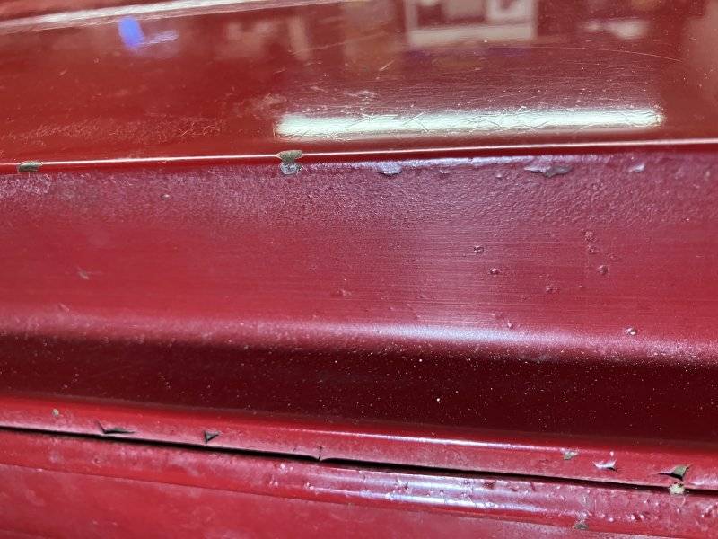

As I noted my tag had round rivets in it as well. Assume it was popped and put back on during exterior painting. I just found it interesting that Bleep Bleeps car doesn't appear to have been painted on the jams and thought that just maybe they were using round head rivets on the line in 65.
I’m uncertain if it’s original. One of the bigger things on the list obviously. I understand its prob (very) unlikely.

In addition to the jambs to my inexperienced eye appears it’s been masked off and paint is just really worn. The data plate finish is relatively better shape than that surrounding fender?
